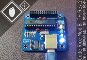

![CR-B-2-TH.cover.png]
This work is the second development board based on ATmega 328P designed by me. Compared with previous projects, this work has a friendly pin sorting and (almost) full direct plug layout while maintaining a small size.
### About direct plug layout
In order to reduce the difficulty of production as much as possible, this work uses direct plug-in components as much as possible. Only the CH340C chip has no corresponding direct plug product. Fortunately, its SOP-16 package is the easiest to solder among SMD components.
For the USB connector, there are two options. Please choose according to your own soldering skills and/or actual needs:
* **USB TYPE-B** connector, as the least loose version of the USB connector, it is widely used in a large number of scenarios including the original Arduino, and its full straight-insert installation method is very friendly to novices;
* **USB TYPE-C** connector, the best connector, its application range and expansion trend must be obvious to everyone; but the 16P SMD version has fine pins, which requires a certain understanding of soldering skills.
![4)@$T(DF(7~%JNA`6KC0{2Y.jpg]
![Y)H(FF`W1H8IT@R56SPU0OD.jpg]
