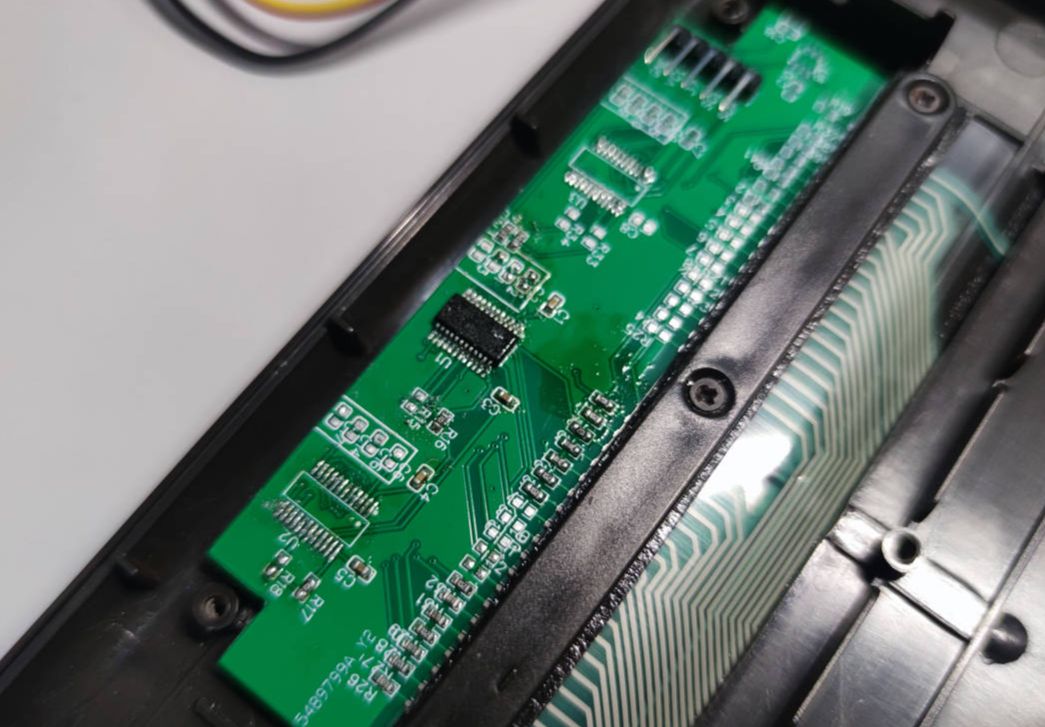

xw12a dream cheeky driver board (semi-finished product)
#### Still can't drive stably
### Features
1. Size within 10x10, can be installed in the original position
2. Contacts that match the size of the soft cable
3. Use xw12a, have micropython driver, use esp
### Problem
1. xw12a can detect touch sensitively, and can even be used as a button by directly connecting wires to the pipe pins. No need for the 1k resistor in the specification.
2. Use 1-100pf capacitors to adjust the sensitivity
3. There is no way to stably detect the keys.
![Snipaste_2023-04-08_18-25-06.jpg] The app has been removed from the app store and cannot be used. The price is extremely low,
