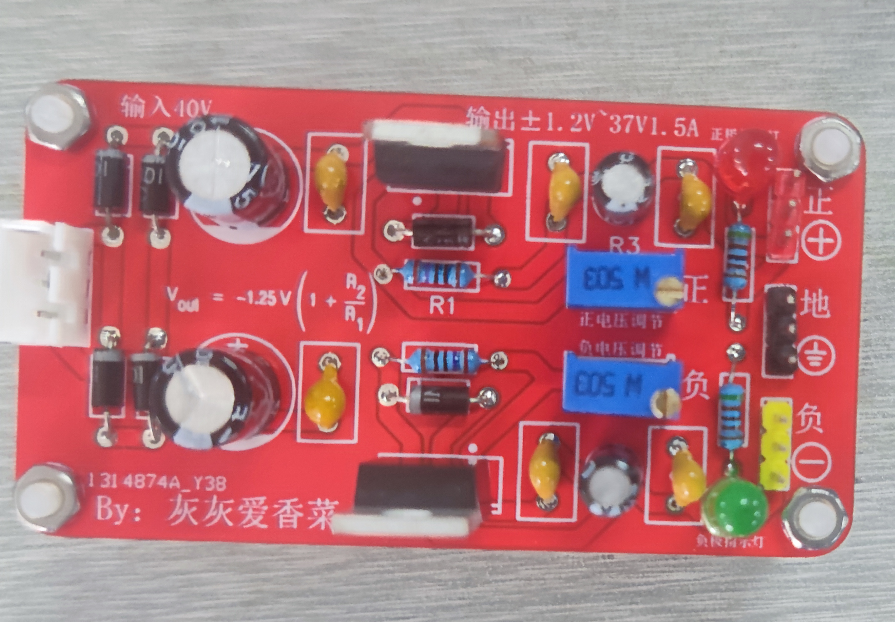

# ***4. Physical display***
***![1.jpg] ![3.jpg]
***![2.jpg]
# **5. Physical display**
The positive power output function is normal
![5.jpg]
**The negative power output function is normal**
![7.jpg]
