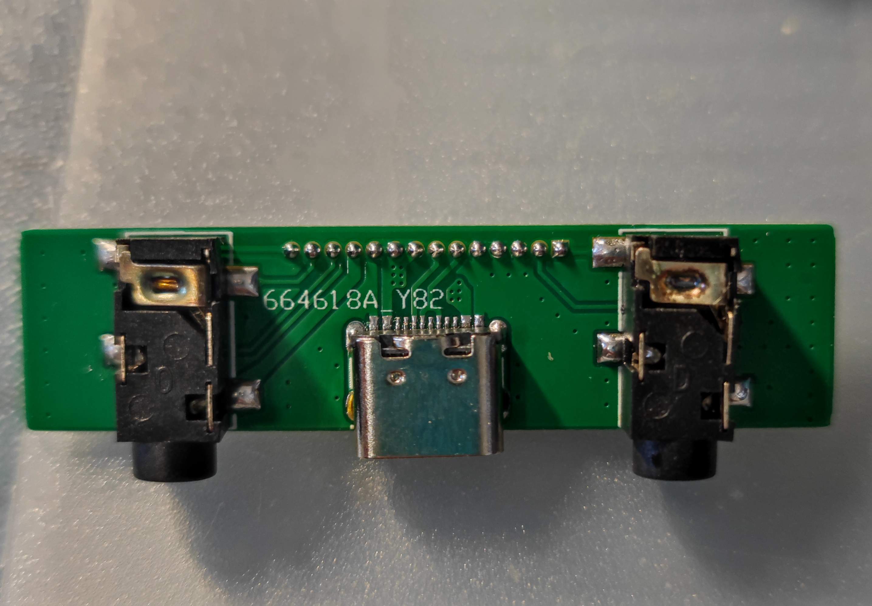

Frsky X9D 2019 changed to type-C power port
x9d 2019 changed the typec
board thickness to 1.6mm.
The original hole position of the back shell was originally equipped with miniusb. It needs to be slightly polished on the two corners of the upper edge.
