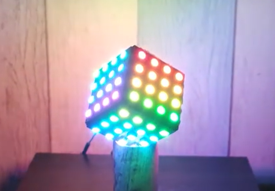

【RA】WS2812 Cube
566786613-1-208.mp4
BOM download
PCB_Lamp Cube_2022-09-22.pdf
PCB_Lamp Cube_2022-09-22.json
Lamp cube_2022-09-22.pcbdoc
Gerber_Lamp Cube.zip
Schematic_[RA]WS2812 Cube_2022-09-22.pdf
SCH_[RA]WS2812 cube_2022-09-22.json
Sheet_2022-09-22.schdoc
62039
