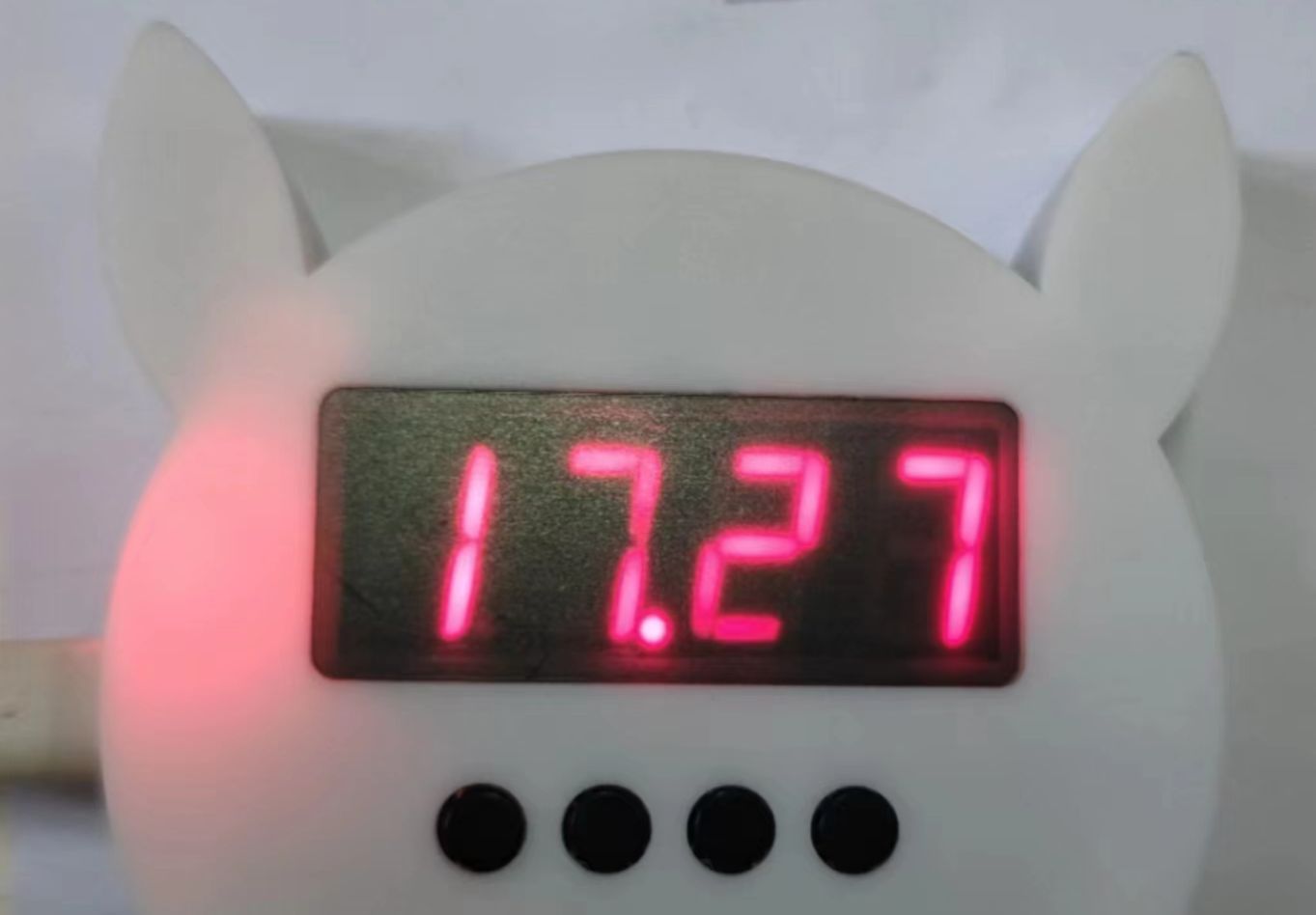

* 1. Introduction to project functions
A simple clock
The first button is for setting time
The second button is for - time
The third button is for + time
The third button is for switching display Time - Temperature - Humidity
Since there is a buzzer, let's use it to play music (*^_^*)
Is this clock practical? Of course, it can't be compared with commercially available products, but as a novice, Xiaobai can still learn a lot through this project (~﹃~)~zZ

uses R7FA2E1A72DFL as the main control. The
actual
temperature display:
Humidity display:
*5. The software and functions
generally refer to Xiao Gong’s code.
Xiao Gong did not set the fourth button. Set it here to the same function as the touch part (it’s not that I’m poor and don’t have Jlink and can’t debug the touch).
Who of my family members understands? I can also make the wrong choice of the digital tube selected according to the video. I can only change the code. P is for temperature. H is for humidity.
Button 1-press and hold to enter the time setting. The order is: hour setting → minute setting → confirmation
. Button 2-minus in time setting, play in play mode. Button
3-plus in time setting, switch music in play mode.
Button 4-switch display mode. The order is: time → temperature → humidity.
Button 1 + button 4-enter play mode, press 4 in play mode to switch back to time display mode.
