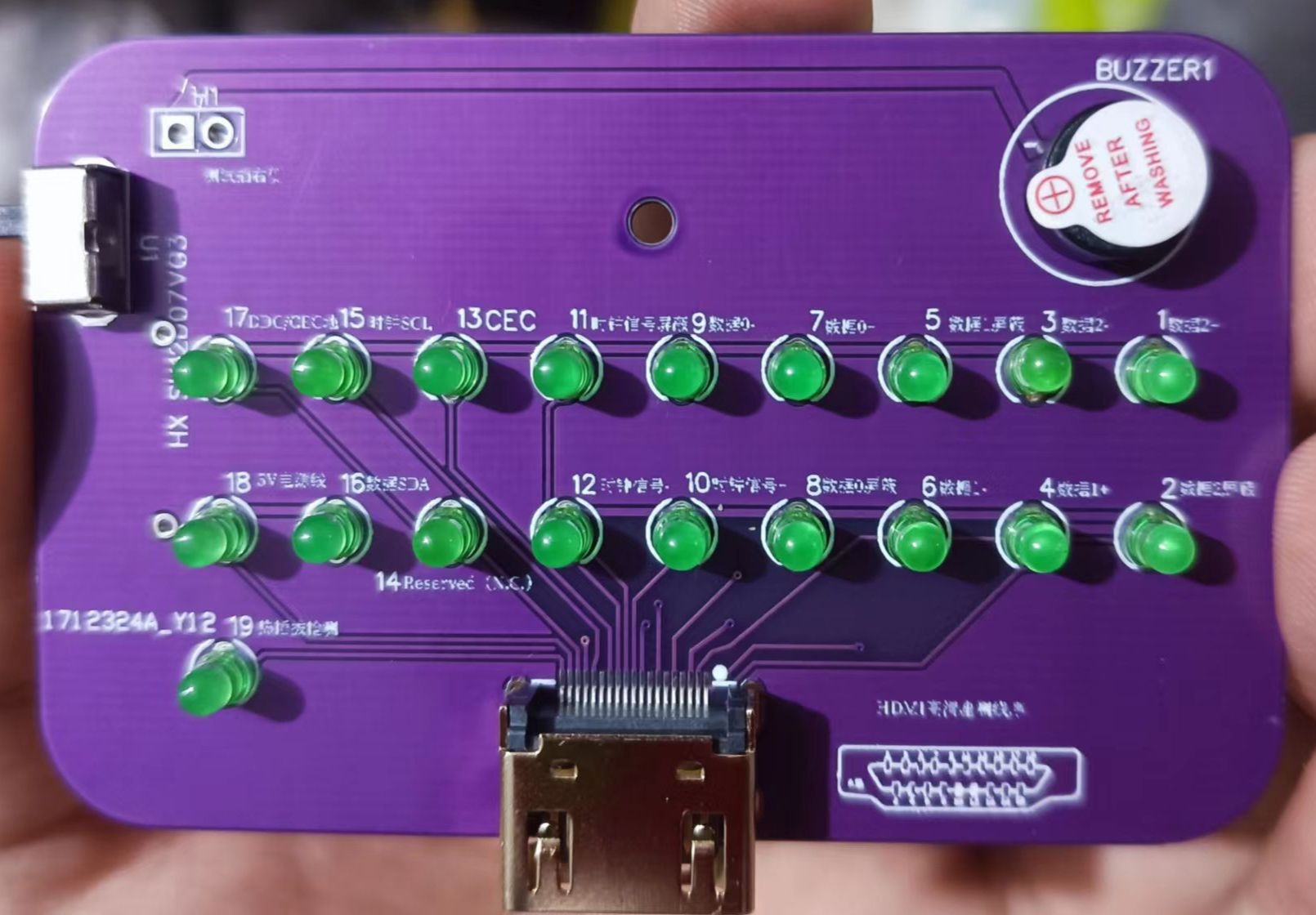

HDMI plug wiring detection line sequence
When replacing the HDMI plug, the wires of different brands have different colors. Use this to detect which color corresponds to which pin. 3-5V power supply, the voltage of the two batteries is slightly lower, the buzzer is not that loud, the LED has a common anode, and the positive electrode connected together has been welded and tested, and the 15-meter-long HDMI is tested for normal use.
