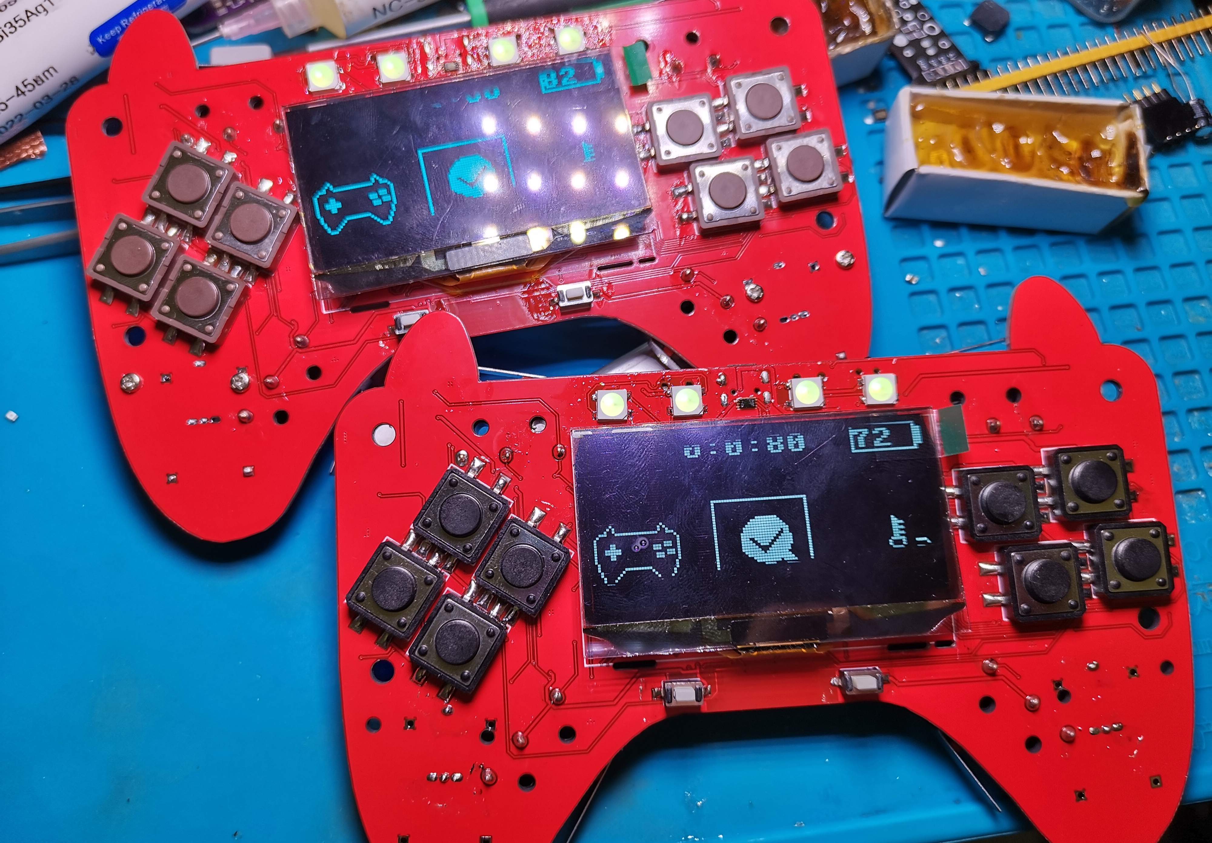

After getting the board with the big handle
, solder the original patch first,
and then solder the sensor patch with a hot air gun.
Then solder the other plug-ins.
Once the soldering is complete, it's time to upload the code. The sensor can be selected not to be welded, and the code will distinguish whether the sensor is welded or not.
There are several types of vibration motors you can choose to weld. The large vibration motor consumes a lot of electricity.
The infrared emitting lamp is welded vertically. After welding, it is bent forward.
After soldering is complete, wipe the board clean. I've welded several. The white screen is a bit disturbing when operating at the i2c frequency. However, there is nothing wrong with my test code, and it works at 10,000 frequencies. The blue screen has no interference.
Check out the test code here for the small handle.
The small handle and the big handle use the same code. The code details are below the small handle description.
