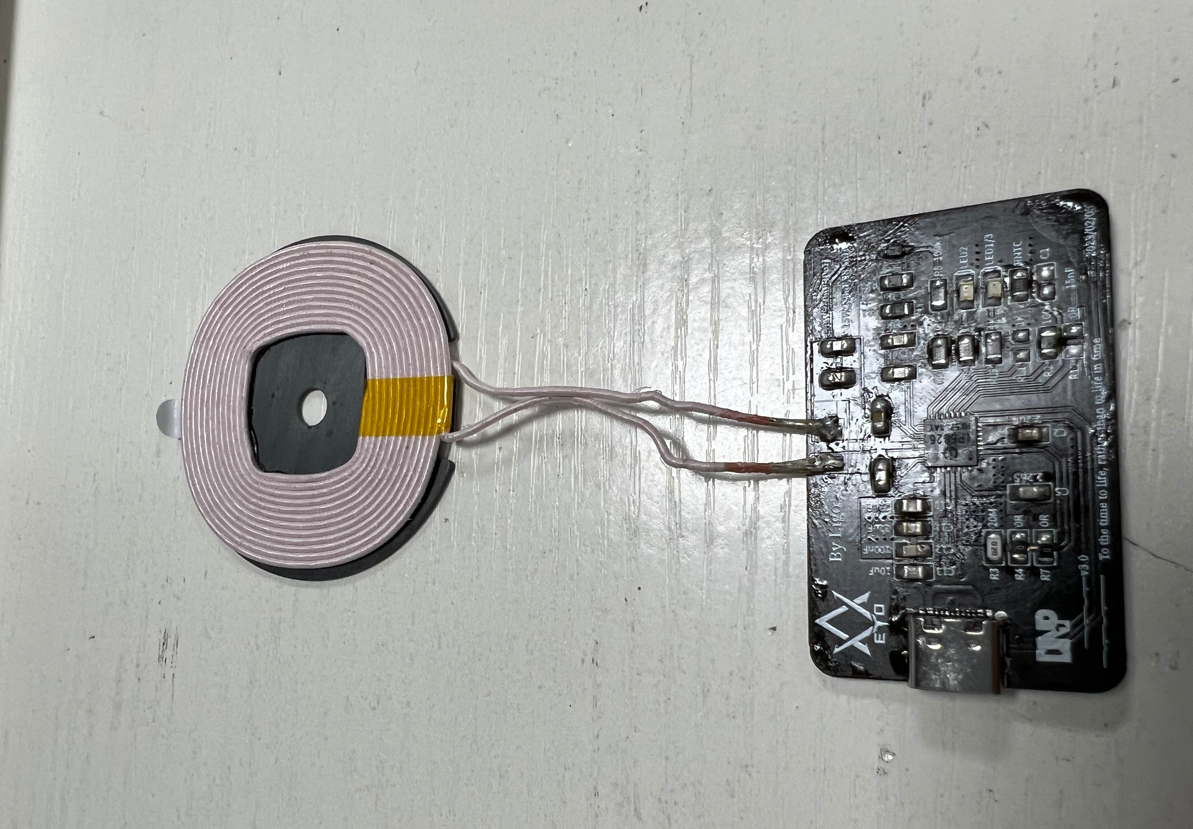

Yingjixin IP6826/IP6829 wireless charger
The original author's open source link
is written at the end:
1: Please support the original author. He is a very awesome junior high school student, and we are still communicating. I remember I was still a will-o'-the-wisp spirit boy at my age.
2: Some precautions have been clearly noted in the original post or my schematic.
3: Except for the main chip and coil, the components in the schematic diagram are all corresponding to the matching 0805 that can be purchased at Jialichuang Mall. (Don’t buy the chip at Jialichuang Mall. It is a white chip with no program. The position of the inductor is the coil)
4: LED1 and LED3 are only connected to each other, and the redundancy is reserved for debugging. If the NTC is not used, connect the 100K resistor directly to ground. DEBUG's 0 Euro is not acceptable.
5: The original author has made version 5, and I have made version 3 myself. I will update after testing 6829, and I will try my best to keep reminding the original author ~
2023-02-09 updated
IP6829, 13PM, and also supports pop-up windows, see the attachment
