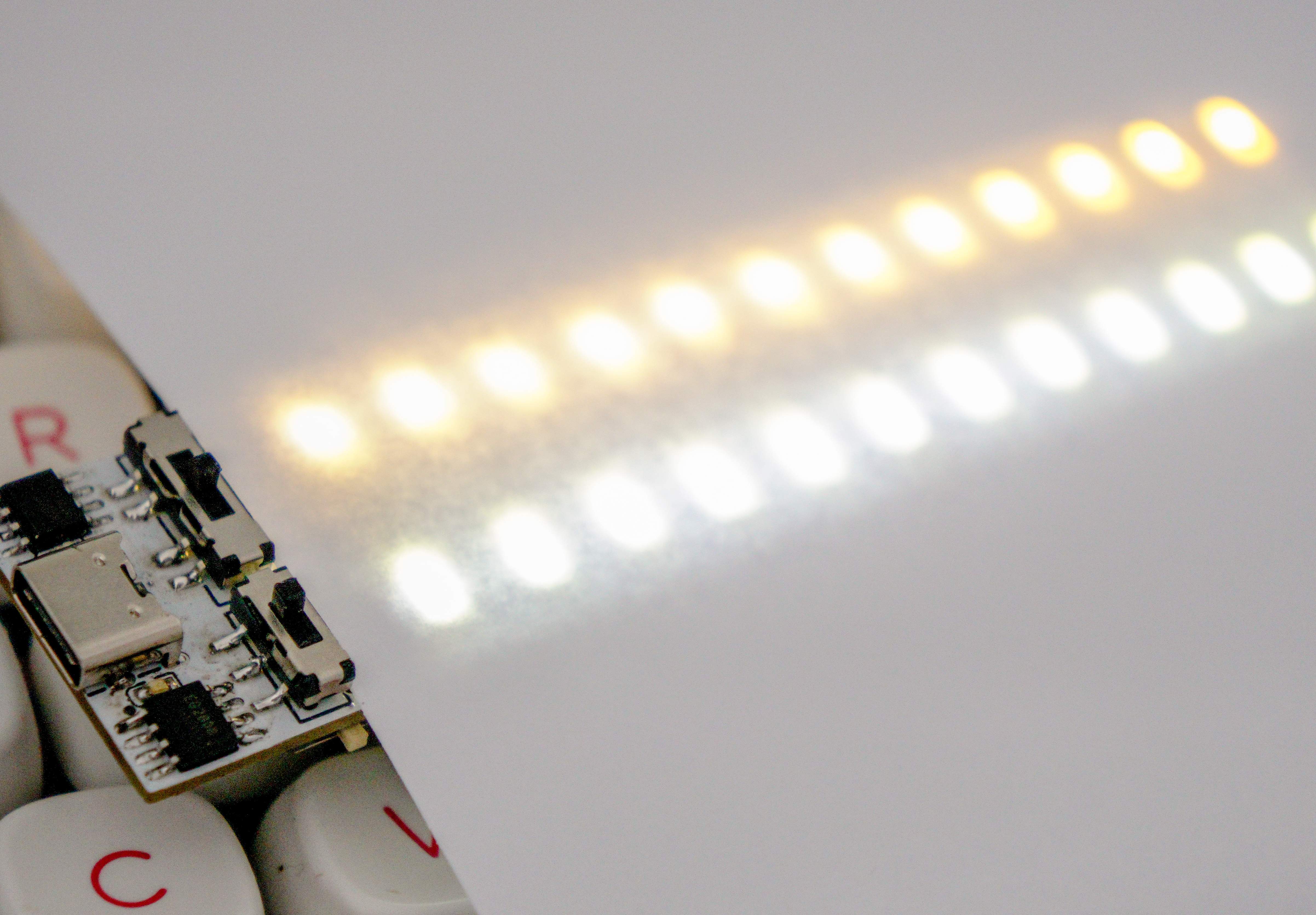

The circuit is simple, pay attention to the direction of the long switch when welding. EG2808 has been discontinued. You can buy it on Taobao. Other Lichuang malls have devices.
Do not replace the capacitors and resistors in the circuit at will, otherwise the circuit will not work!
When charging, turn the toggle switch to the "on" position, and when not in use, turn the toggle switch to the "off" position. This ensures long standby time.
The key switch on the back provides an alternative touch function. If it is inconvenient to touch while wearing gloves, you can use the keys instead of touch.
Be careful not to weld the wrong direction and position of the three chips. There is also a long switch. If welded backwards, it will cause switching problems. It is recommended to use a light panel with an aluminum substrate.
It is better to buy a teppanyaki and solder paste.
