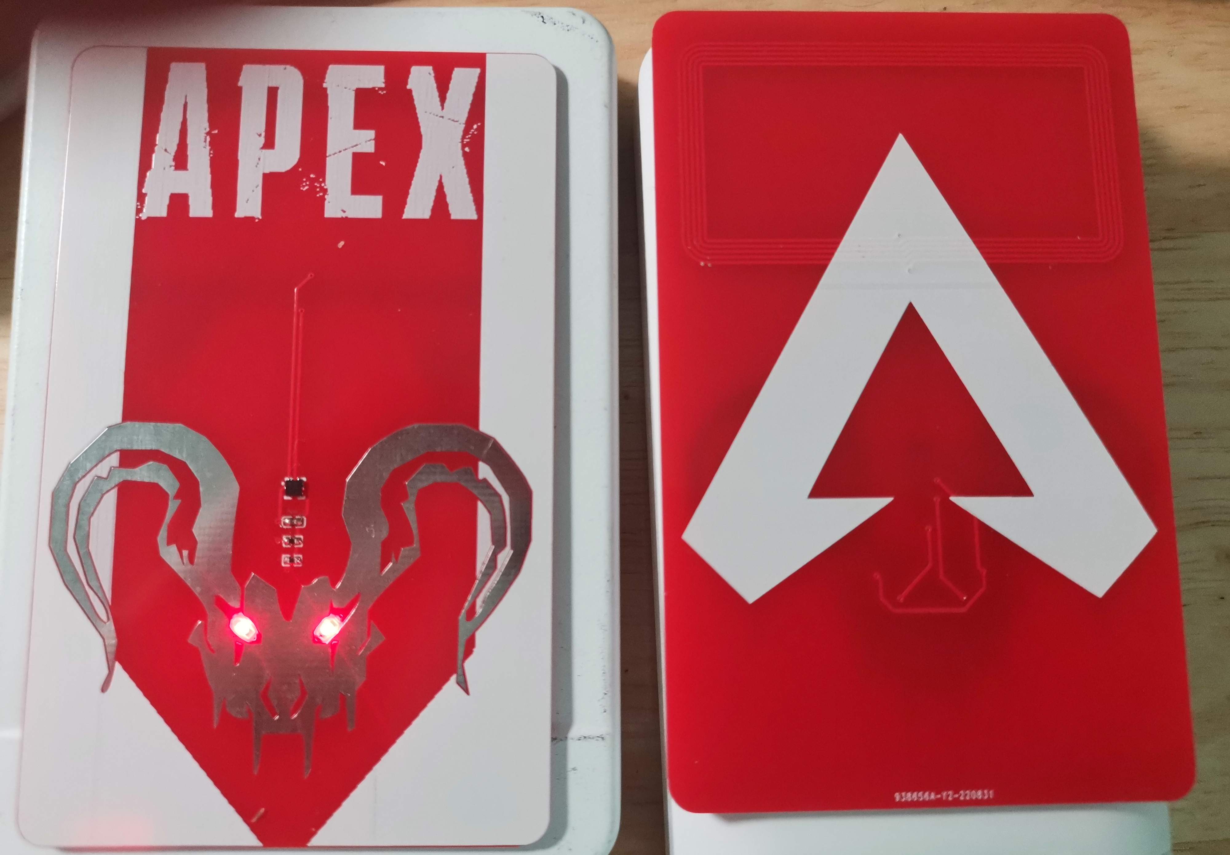

APEX invitation letter (NFC card)
NFC chip NT3H1101W0FHKH Taobao 3.6 without shipping/4.8 with shipping (you can buy more to prevent welding failure)
Resistor 0402 47Ω
Capacitor 0402 220nF
LED 0402
Recommended board thickness 0.8-1.2
NFC chip is very difficult to solder with a soldering iron, it is recommended to use solder paste + hot air gun or heating table
For the non-NFC version, you can change the back screen printing to a window, or try to print the aluminum substrate.
Use https://oshwhub.com/Knight_Sin/PCBzhao-pian to import some pictures into PCB
