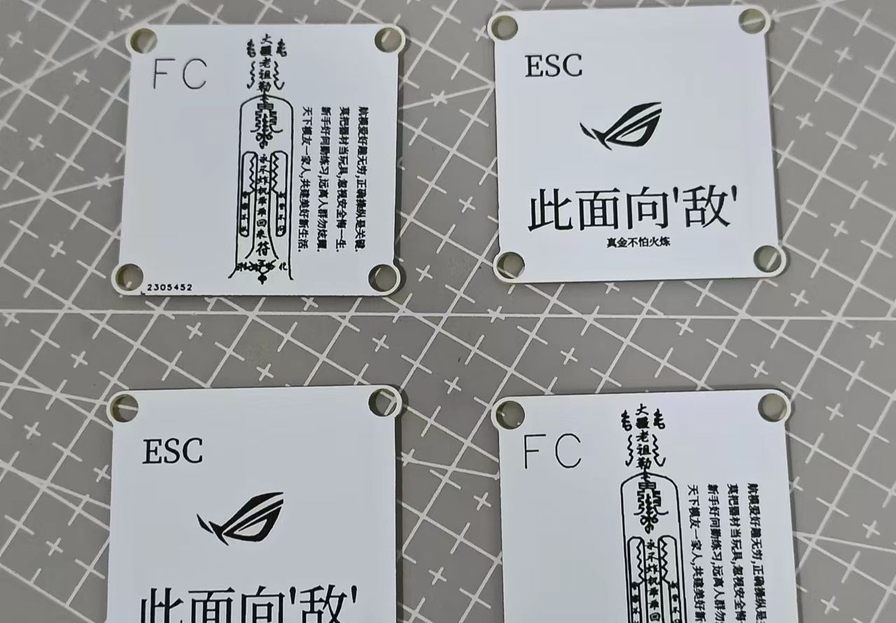

Flight control partition 30x30
30X30mm hole spacing, suitable for standard size flight controller.
M3 installation hole diameter, "this side facing the enemy" is facing the ESC,
used to separate the flight controller and the ESC to prevent the ESC from interfering with the flight controller IMU MCU when running at high power.
At the same time, it protects the flight controller from being hit by the ESC.
