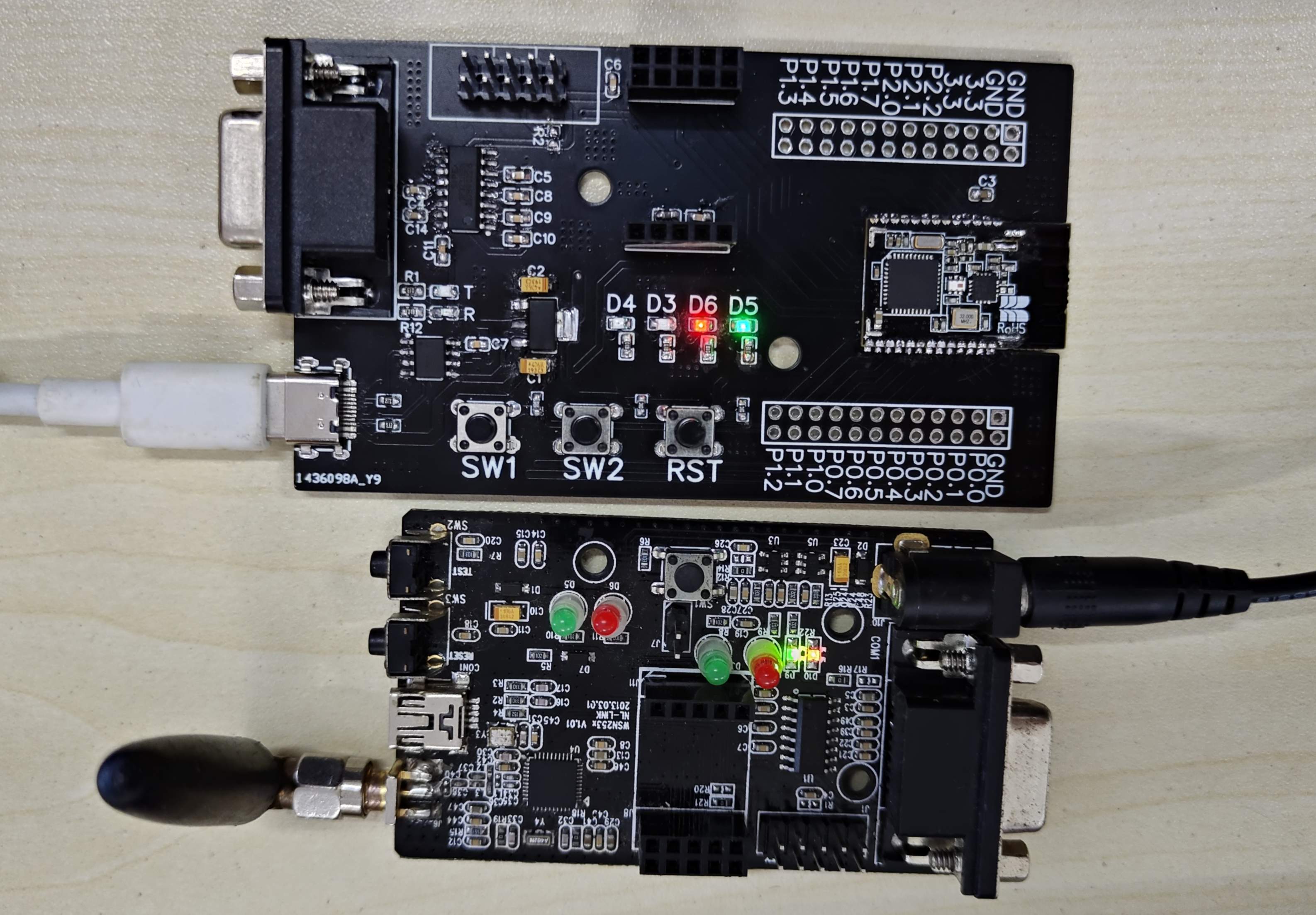

Compatible with Newland Zigbee development board CC2530 PA2
Advantages:
        The module adds a 340N serial port chip, and only one Type-c is needed to use the serial port, without the need to use an additional serial port to USB data cable, which is more convenient than the new world.
        All Gpio ports are fully led out, but the module does not have USB IO.
        Correctly configure the IO connected to the PA, and the transmission distance is farther than the new world.
Disadvantages:
        No battery power supply interface is designed.
        The volume is too large.
        Because the module with PA is used, the IO levels of P1.1 and P1.4 need to be configured, and the IO will conflict with the title.
        When the PA chip is not started correctly, two zigbee modules need to be close together to barely have a signal.
