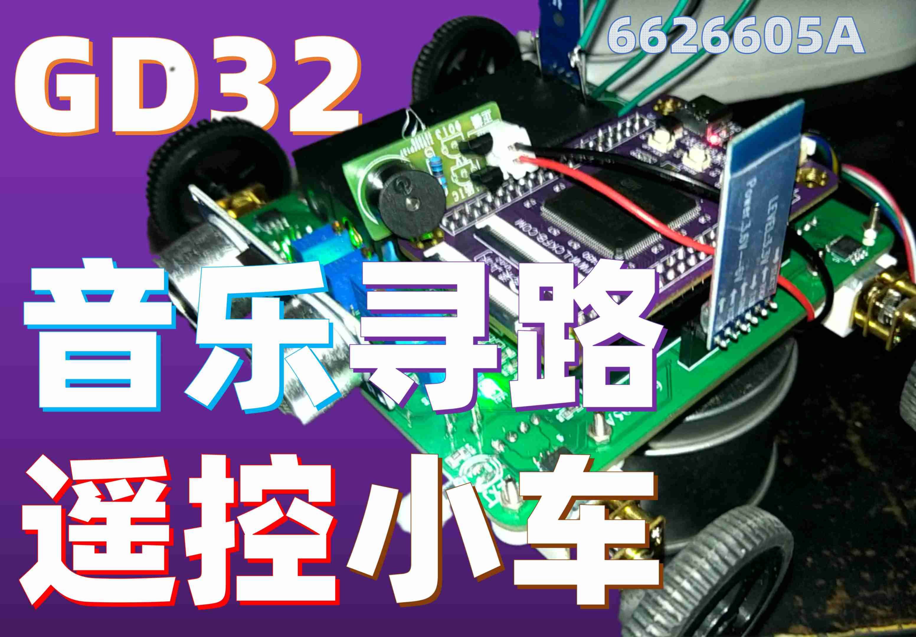

# Introduction
This is a smart car based on GD32. The car has functions such as music, tracking, navigation, Bluetooth, power display, etc. The specific introduction of these functions can be seen in the schematic diagram below.
When designing the PCB circuit, a size of 99*99mm was used.

! [Main Controller] The main controller uses the Liangshan Development Board, which has GD32F470 on board.

! [Motor] The car is a four-wheel drive car. Considering the actual situation, the car bracket is not set, but the motor is directly loaded on the PCB. The motor uses an N20 motor, which is suitable for small PCBs and easy to install.

In the original video tutorial, PNP is used. In the actual circuit test, it was found that the buzzer module would ring as long as it was powered on, and it was not controlled by the pin. After discussion in the group, it is suspected that the buzzer pin must be set to a high level from the moment of power on to prevent it from ringing. If the pin is floating or waiting to output a low level, a loop is indirectly formed to pull the base down, and it will naturally ring. The normal solution is to just replace it with an NPN.
Since my PCB has been soldered and the components have been bought, I don't want to bother. So in the project implementation, I directly used a separate buzzer module to implement it.
## Flying line description
In the actual implementation, in order to complete the project, I had to use flying lines.
1. Battery holder flying line: This reason is stupid. I didn't pay attention when I bought the battery holder. As a result, I found that the positive and negative poles of the battery holder and the PCB were reversed after receiving the goods... There was no space at the bottom of the PCB... So I had to use flying lines.
2. Music module flying line: Because the size of the PCB designed at the beginning was 99*99mm, considering that there might not be enough space, and the PCB had been roughly designed at the time, it was not attached to the main board, but became a separate module.
