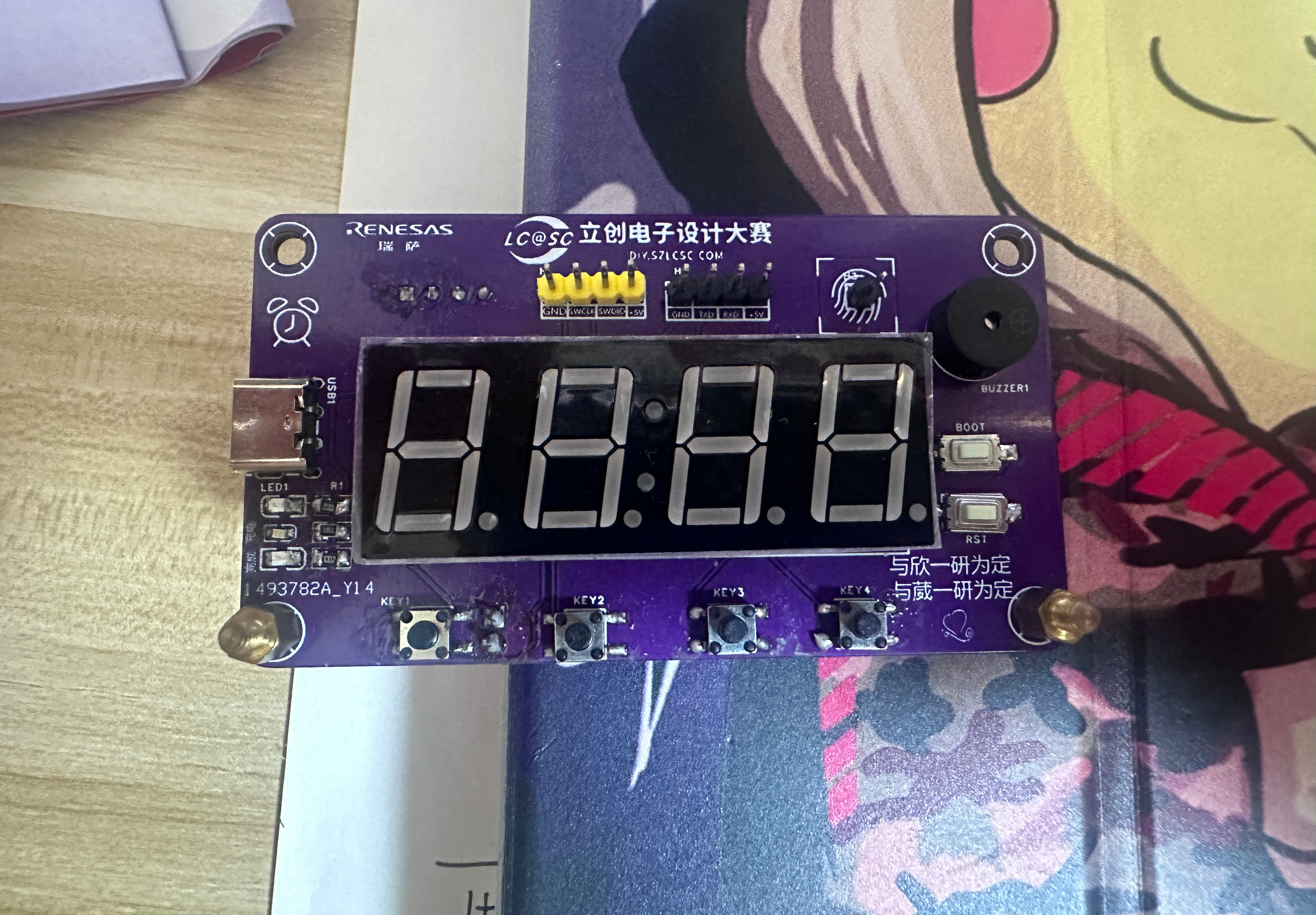

* 1. Project function introduction:
The desktop electronic clock is designed based on the R7FA2E1A72DFL chip. The time and temperature are displayed through a four-digit 0.56-inch common cathode digital tube. The DHT11 temperature and humidity sensor is used to collect the ambient temperature and humidity. The reset button, serial port circuit, and SWD download circuit are all led out for easy download and debugging.
*2. Project attributes
1. Main control chip: R7FA2E1A72DFL;
2. Power interface: TYPE-C, 2Pin plug-in;
3. LED: one power indicator light, one charging status indicator light;
4. Buttons: one reset button, one BOOT button, four function buttons;
5. Debug interface: SWD download debug interface, serial port download debug interface, both use 2.54 pin header interface for lead-out;
6. Peripherals: one 0.56-inch common cathode digital tube, one DHT11 temperature and humidity sensor, one passive buzzer;
* 3. Advantages and characteristics
1. The onboard appearance is small, with a size of only 3115.0mil*1470.0mil;
2. Complete download and debugging interfaces;
3. Using power switching circuit, it can continue to work through lithium battery power supply even when power is off;
4. Low price and complete functions;
5. Use Jiali Chuang high-quality PCB and genuine components to ensure product quality;
