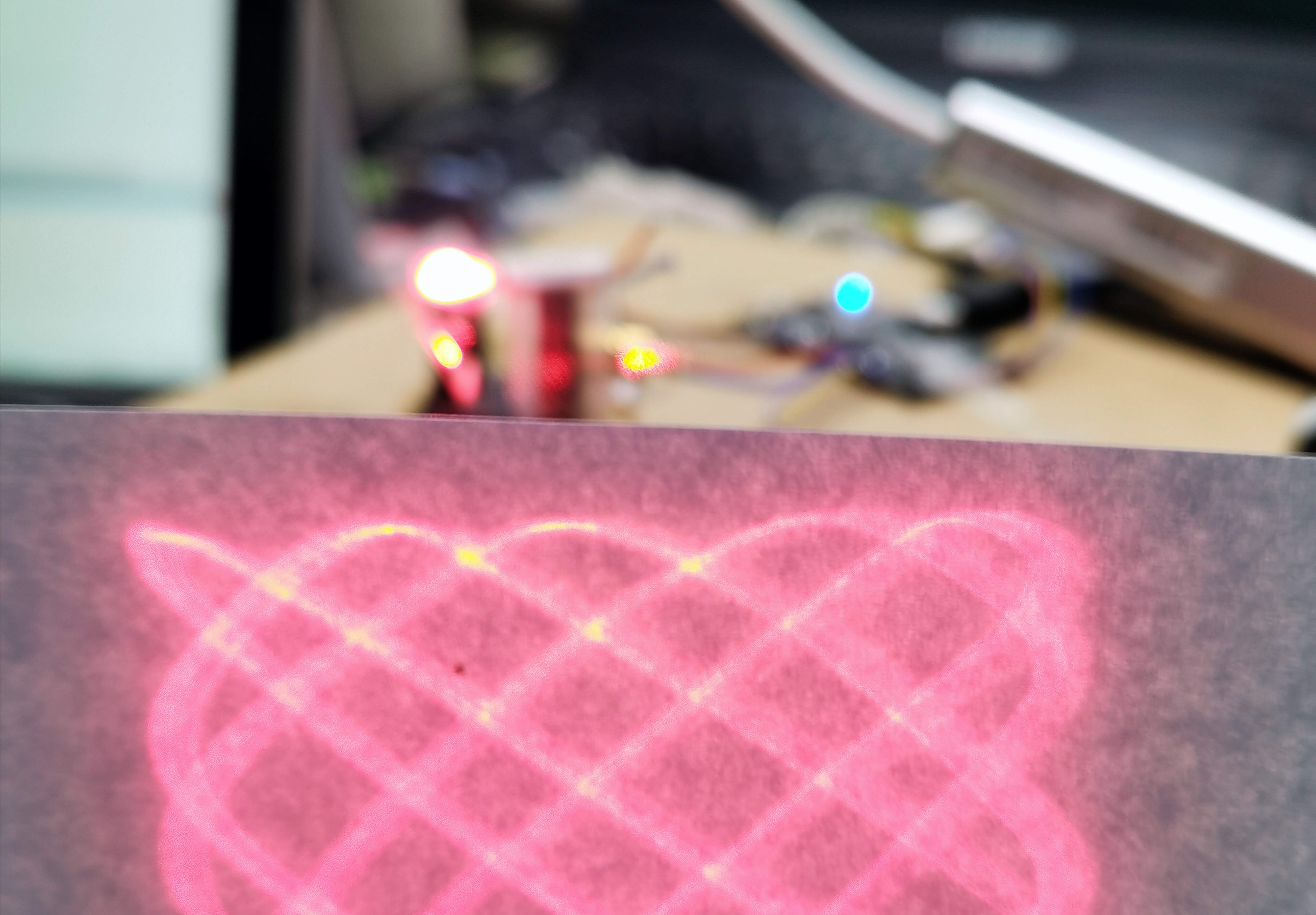

This project implements basic laser projection functions, including PCB, driver, and 3D printing shell, with a volume of 5x4x5cm. The Hangshun HK32F030MF4P6 main control is used to drive two motors to control the XY-axis reflectors respectively, using the persistence of vision effect to achieve projection.
Designed for low cost, the unit price of the BOM without battery function is only 5.81 yuan, the price of the complete set including the shell is less than 10 yuan, and the total price with lithium battery is less than 25 yuan (large enough lithium batteries are really expensive). MCU-IO multiplexing is compatible with stm8s103 and leads to the SWIM interface. Changing the main control IO will not cause the function to be incompatible, except that stm8 does not have I2S function and can only be simulated by software.

As we all know, mirrors reflect light. When the light point passes through the curtain, a glowing trajectory will be seen due to the persistence of vision effect. Install a mirror on the motor shaft, and the light path changes as the motor rotates. In addition, the motor moves back and forth within a small angle, and the reflected light from the mirror will form a strip.
Install the two motors at 90 degrees, and their reflected light will cover the flat area. One motor controls the X-axis and the other controls the Y-axis to achieve two-dimensional control of the light spot position. When the laser diode switch is turned on and off, it can be freely displayed and projected.
In order to save costs, we used cheap audio DAC and audio amplifier to control the motor. The main control uses the I2S interface to output audio signals and drives the motor to deflect to achieve projection.
