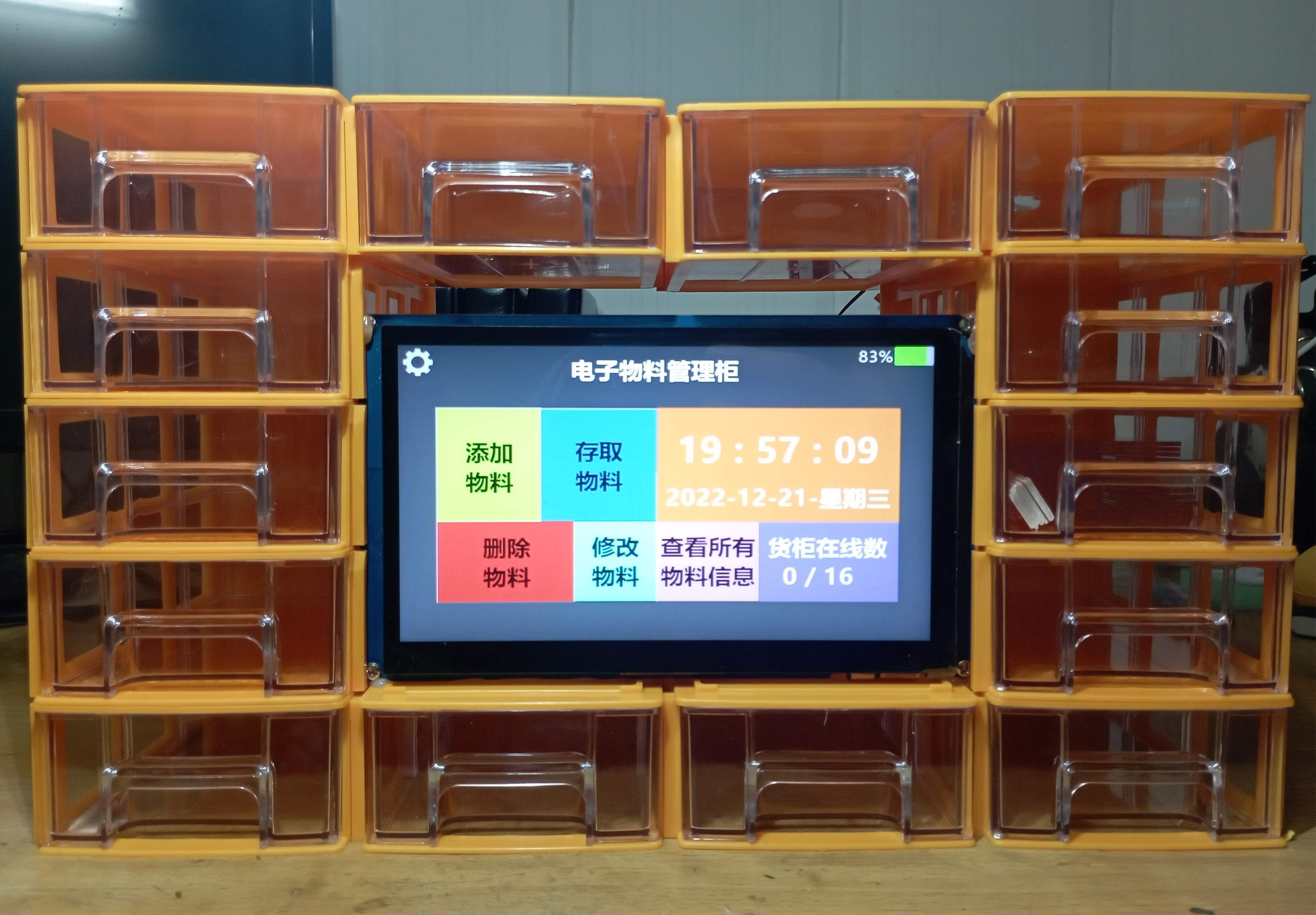

Display:
Lichuang Liangshan School - Physical electronic material storage box
PCB:

1. Screen UI
data link: http://wiki.tjc1688.com/doku.php? id=start
This screen has powerful functions. I directly put the time calculation display function on the screen and run it myself (the screen has its own RTC function); as long as the microcontroller transmits a starting time to the screen at the beginning, the screen can run the clock effect.
The [Seven-inch screen electronic material management cabinet.HMI] in the attachment is the UI interface designed based on this project.
