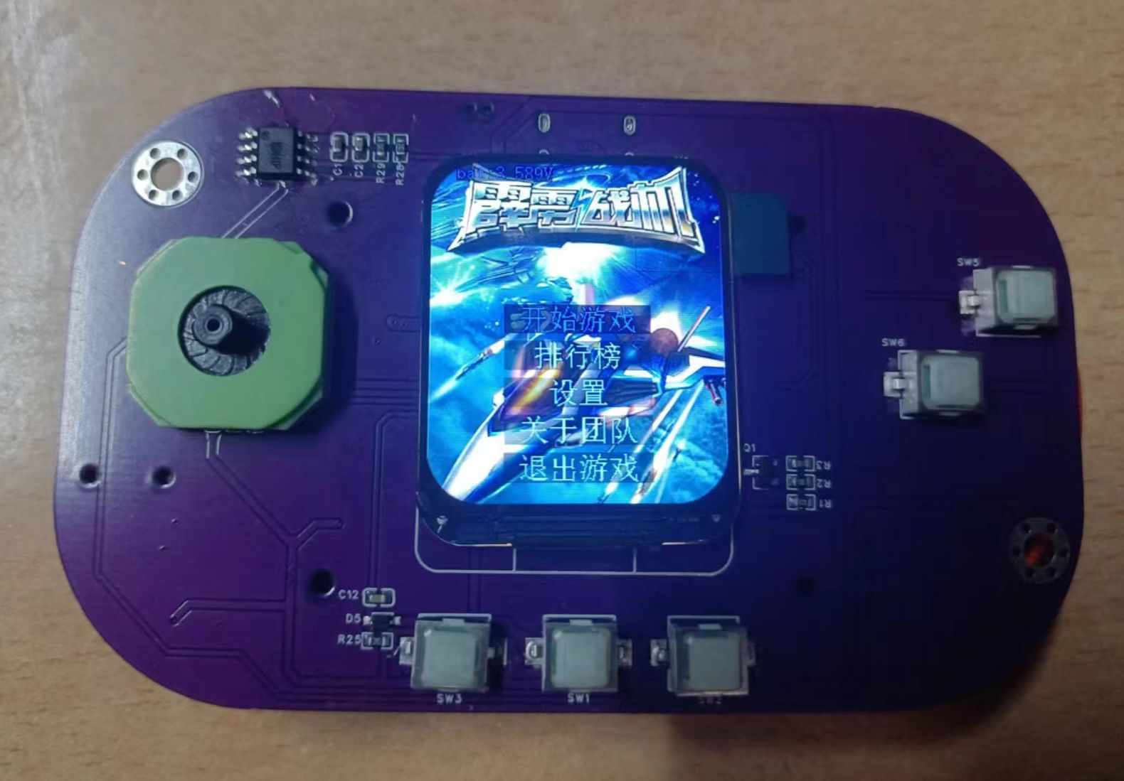

### Actual picture
![189ff01b78ed955fb37a92f28d8416a.jpg]
![WeChat picture_20230520213159.j pg]
![WeChat picture_202305202131591.jpg]
