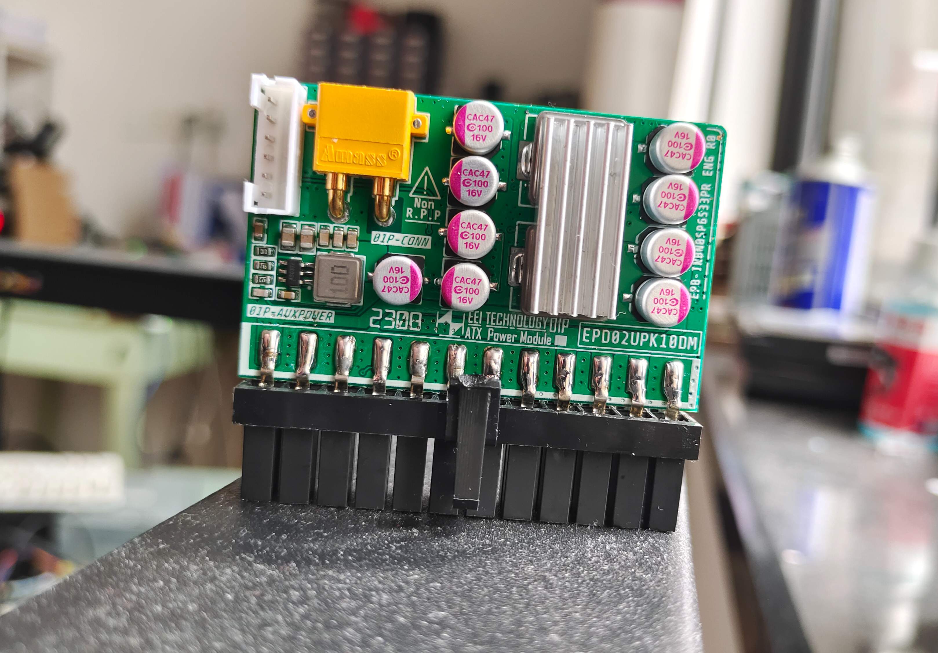

DC-ATX power conversion module
# EEI TECHNOLOGY 01P-HexaGon Series Project[EPD02UPK10DM]ATX computer power converter
## Main parameters
* **VBUS maximum input voltage: 13V**
* **VPRE auxiliary power supply maximum input voltage: 19V**
* **#1 rated Output: +5V±1% 8.0A continuous 10.0A peak (30℃ natural cooling)**
* **#2 rated output: +3.3V±1% 8.0A continuous 10.0A peak (30℃ natural cooling)**
* **Auxiliary power supply rated output: +5V ±1% 1.3A (maximum) (30℃ natural cooling)**
* **+5V output ripple: 50mVpp (20MHz BW) (ILoad = 10A)**
* **+ 3.3V output ripple: 45mVpp (20MHz BW) (ILoad = 10A)**

## Special material
* **The solid capacitor on the board is Lichuang material number: C494511**
* **[24P plug purchase address](https: //item.taobao.com/item.htm?id=585584111861)**
## Special attention! !
* **Before using the computer, be sure to repeatedly confirm that the output voltage of each channel is normal to avoid damaging the computer hardware! **
