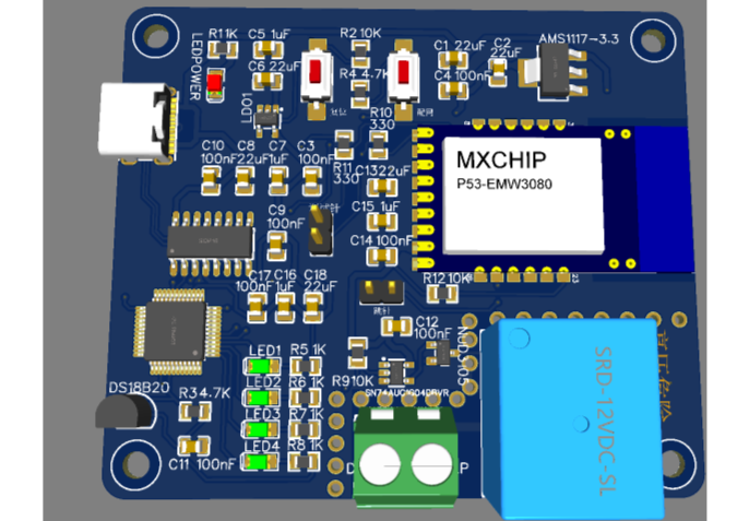

The IoT switch
master control based on 51 microcontroller is 51 microcontroller. It should be considered the best 51 microcontroller at present, but it is still a little behind STM32.
The IoT module uses the EMW3080 module. The specific use requires guidance from the teacher:)
The relay circuit passes 51 The microcontroller sends a 0 signal to the relay terminal and completes the 5V coil to close the 220V contact.
Updated on August 17. Add a diode to the communication line between the CH340C and the microcontroller to prevent current backflow;
reorganized the power supply part of the CH340C and corrected the error part;
August On the 20th, the code for the device AP distribution network was corrected;
on August 21st, I felt that welding was a bit difficult, and 5 scrap boards were produced. . . .
Prepare to re-sample. . .
