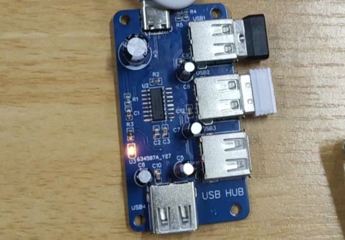

USB docking station based on HS8836A
The CC identification resistor is added, and the C to C data line
VCC can be used. The thickened VCC can be used to charge peripherals such as wireless keyboards. The measured short-term current can be up to 2A
using 0805 resistors and capacitors. Manual welding is convenient
for writing to U disks
from U. Disk reading
