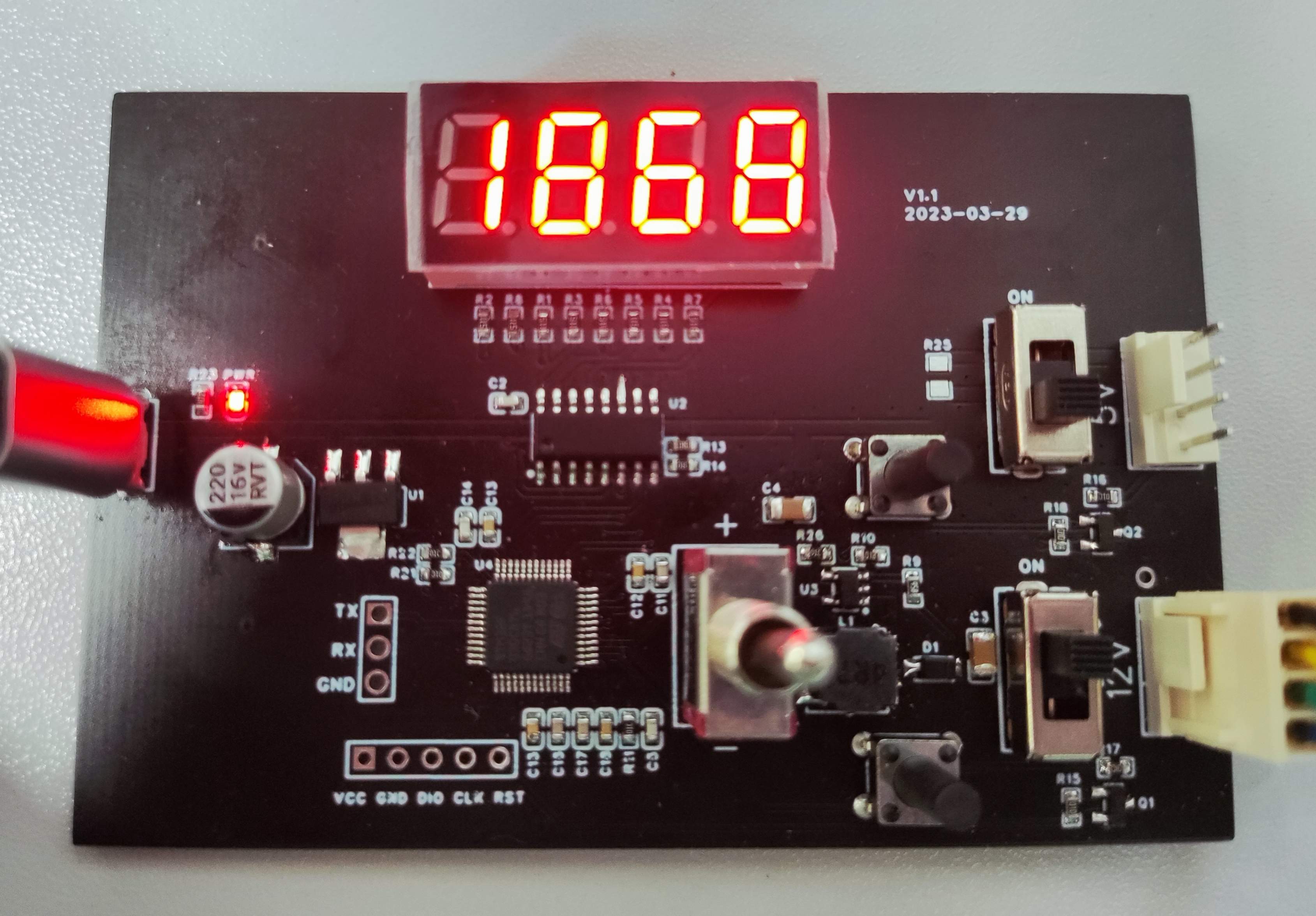

![IMG_20230401_133634.jpg] ![IMG_20230401_132958.jpg] ![IMG_20230401_133206.jpg]

MCU: STM32F030C8T6
digital tube driver: CH455G
5V to 12V boost: MT354 0-F23 (note that this chip has 3 specifications , corresponding to 3 kinds of FB voltages. This project uses 1.23V. If you use other voltages, you need to modify the corresponding FB resistor value)
5V to 3.3V step-down: AMS1117-3.3
uses USB 5V power supply, and 4 pins are 5V straight out, suitable Low-voltage small fan, the other channel is 12V boost output, suitable for 12cm chassis fans. The two fans are independently controlled, and two touch buttons are used to select and display the speed of which fan. The self-resetting button is used to adjust the PWM duty cycle to control the fan speed. When adjusting the speed, the digital tube displays the current duty cycle, and automatically switches to display speed (RPM) after 2 seconds of no operation. The fan speed defaults to 50% after power on.
Since the charging of the capacitor will instantly lower the voltage when powering on, the CH455G delays initialization for 1 second, otherwise the initialization may fail due to voltage instability.
Except for the self-resetting buttons in this project, all the components can be found in Lichuang Mall, and the cost of a single finished product is less than 10 yuan.
STM32F030C8 is completely overkill in this project, but why did I choose this MCU? Because the company has ready-made ones for free... and ST's ecological chain is so comfortable. The underlying CubeMX is directly generated, and you only need to write it yourself Just the application layer is enough, there is no need to manually configure so many registers. The entire code writing + debugging only took half a day.
**If you want to save costs, you can use an 8-bit MCU with fewer pins instead, but it is strongly recommended to choose a model with the following specifications: **
At least 2 independent timers, one for PWM precise output and one for For accurate speed measurement and system ticking,
at least 2 GPIO ports that support edge triggering are used to detect speed measurement signals.
At least 1 hardware I2C port is used to drive the CH455G digital tube display.
An optional hardware UART serial port can be used to communicate with the host computer to achieve The host computer can control and read the speed, and you can even use a wireless module to achieve wireless control.
If you choose a 5V power supply microcontroller, you can also save 3.3V LDO.
**If you want to use it to control a high-power violent fan, be sure to switch to one that supports high current. Type-C interface and uses a higher power DCDC chip. Or directly switch to DC12V or PD input, and then reduce the voltage to power the MCU for control, and the fan directly uses DC power supply. **
