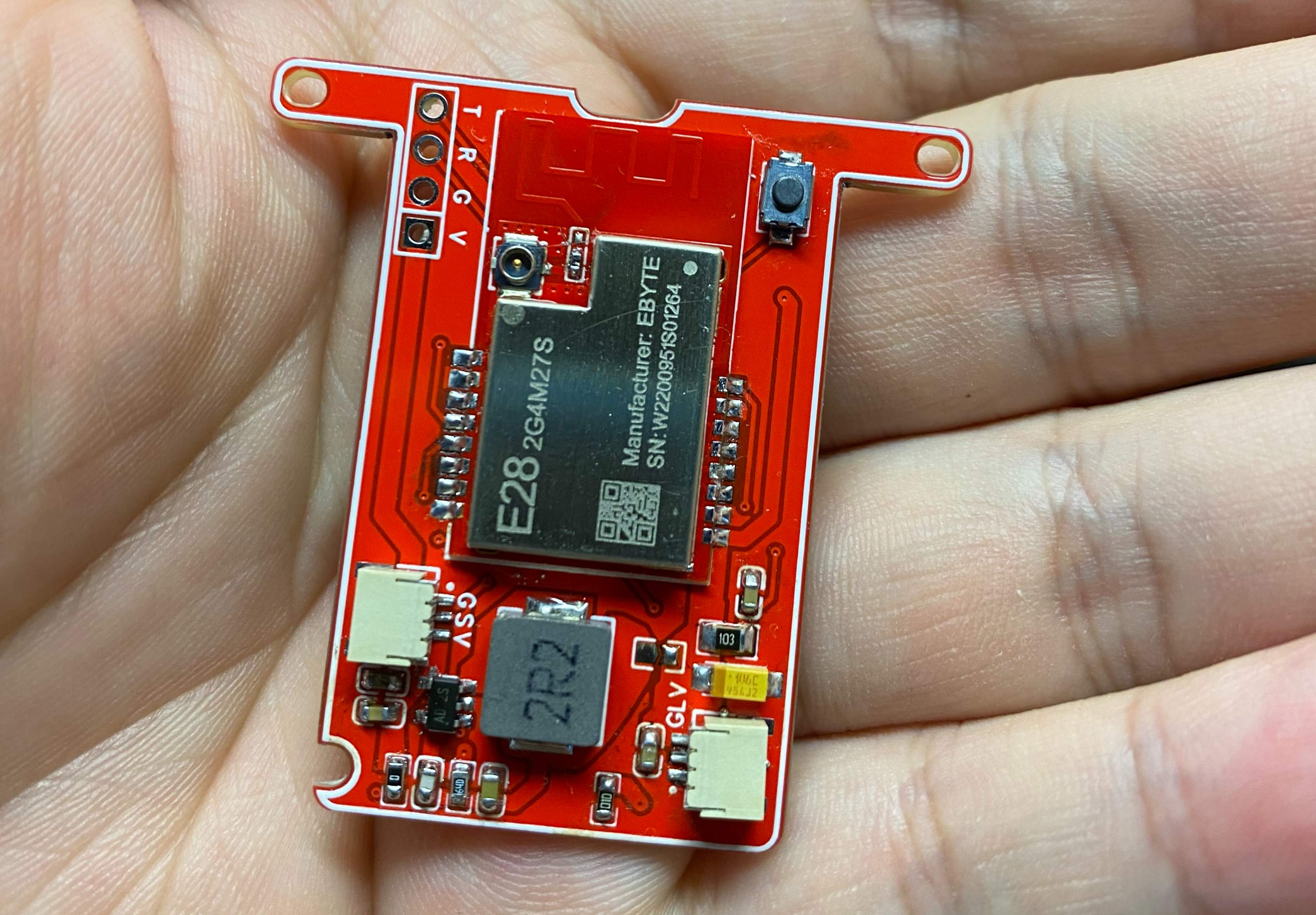

tango2 built-in elrs motherboard (esp32module version)
The module is made of esp32 module, which is easy to weld. It is designed with a dcdc module. At the same time, the external high-frequency head interface of tango2 needs to be adapted and needs to be used with an adapter board. The installation method is the same as the video of this up owner. The original author directly placed a minimal system on the board. It felt that it was too difficult to solder, so he drew a version using modules.
It can be turned up to 500mw, but the heat dissipation may not be able to keep up, so it is recommended to turn it up to 250mw
[Black Sheep Tango2 built-in ELRS] https://www.bilibili.com/video/BV1DP4y1N7P9/?share_source=copy_web&vd_source= When installing af6399196d5a776d70dc988a52776166
, three m2 copper pillars are needed to replace the original three screws of tango2. Since they are tapped, they can be screwed in directly. However, do not disassemble and assemble multiple times, as it will feel slippery if used too many times. Silk.
The link to the adapter board is https://oshwhub.com/xzxzxzxzxaaa/tango2-zhuan-jie-ban.
The line connected to the adapter board is a 3p sh1.0mm interface line. The line connecting the adapter board to tango is 8p. The 1.0mm FPC cable, the same direction and the reverse direction depend on whether the FPC interface on the adapter board is connected up or down. You can refer to the directions in the video link above. When using downlink connections, the cables should be placed as shown in the video.
If you feel that the access position of the adapter board in the video will damage the mushroom sticker, you can use my adapter board placement method.
