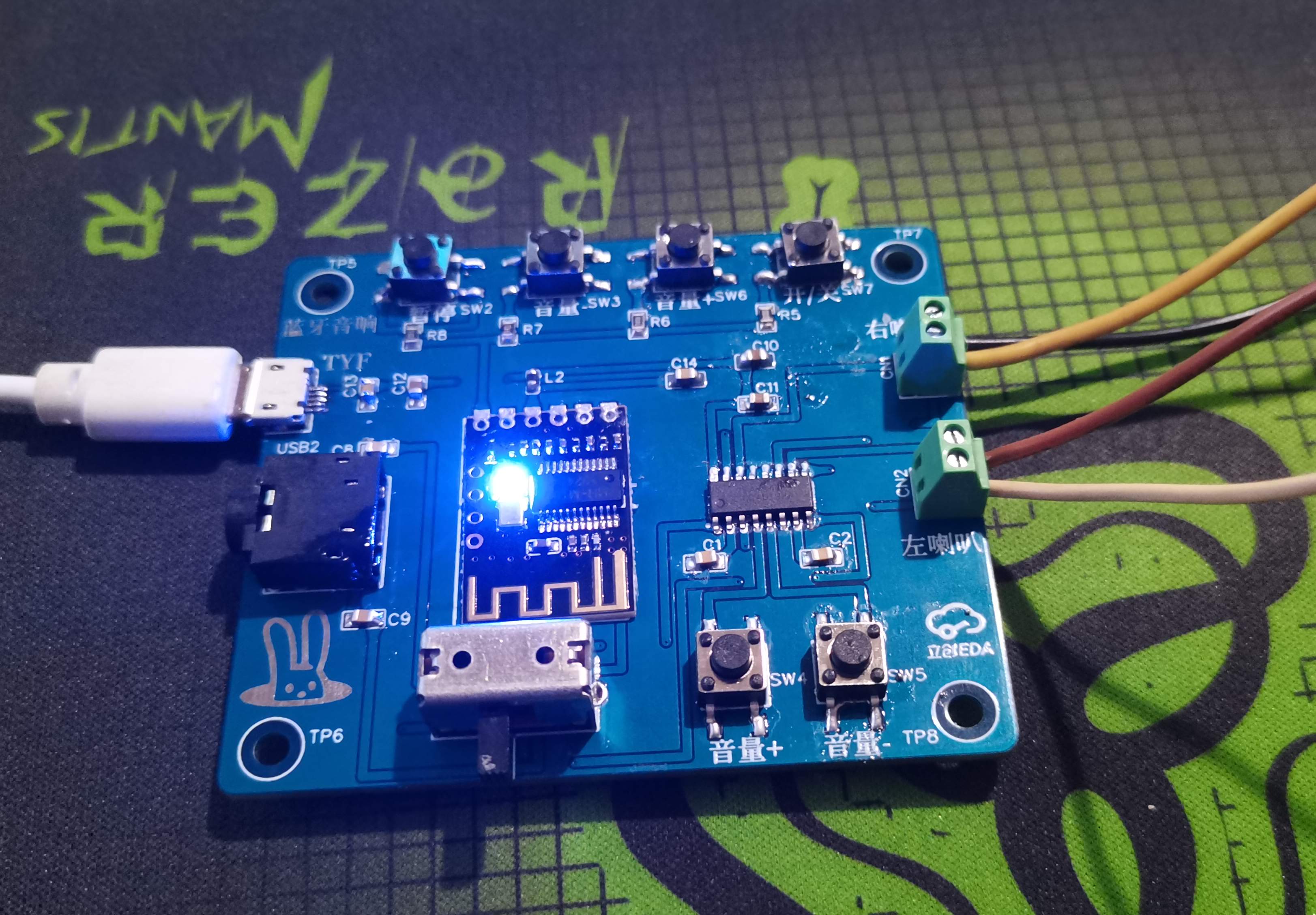

It uses a power amplifier to make speakers and has Bluetooth function, and can switch the audio input mode between Bluetooth and 3.5mm audio input through a sliding switch.

Use Lichuang EDA to draw the schematic diagram and PCB. Based on the PAM8407DR Class D power amplifier, the audio input end is connected to a sliding switch. The sliding switch realizes switching between Bluetooth and 3.5mm headphone jack. The Bluetooth part uses the m18 Bluetooth module. During the test, the computer USB power supply was used, but it was found that it could not be carried, so other larger current power supplies were used to solve the problem.
