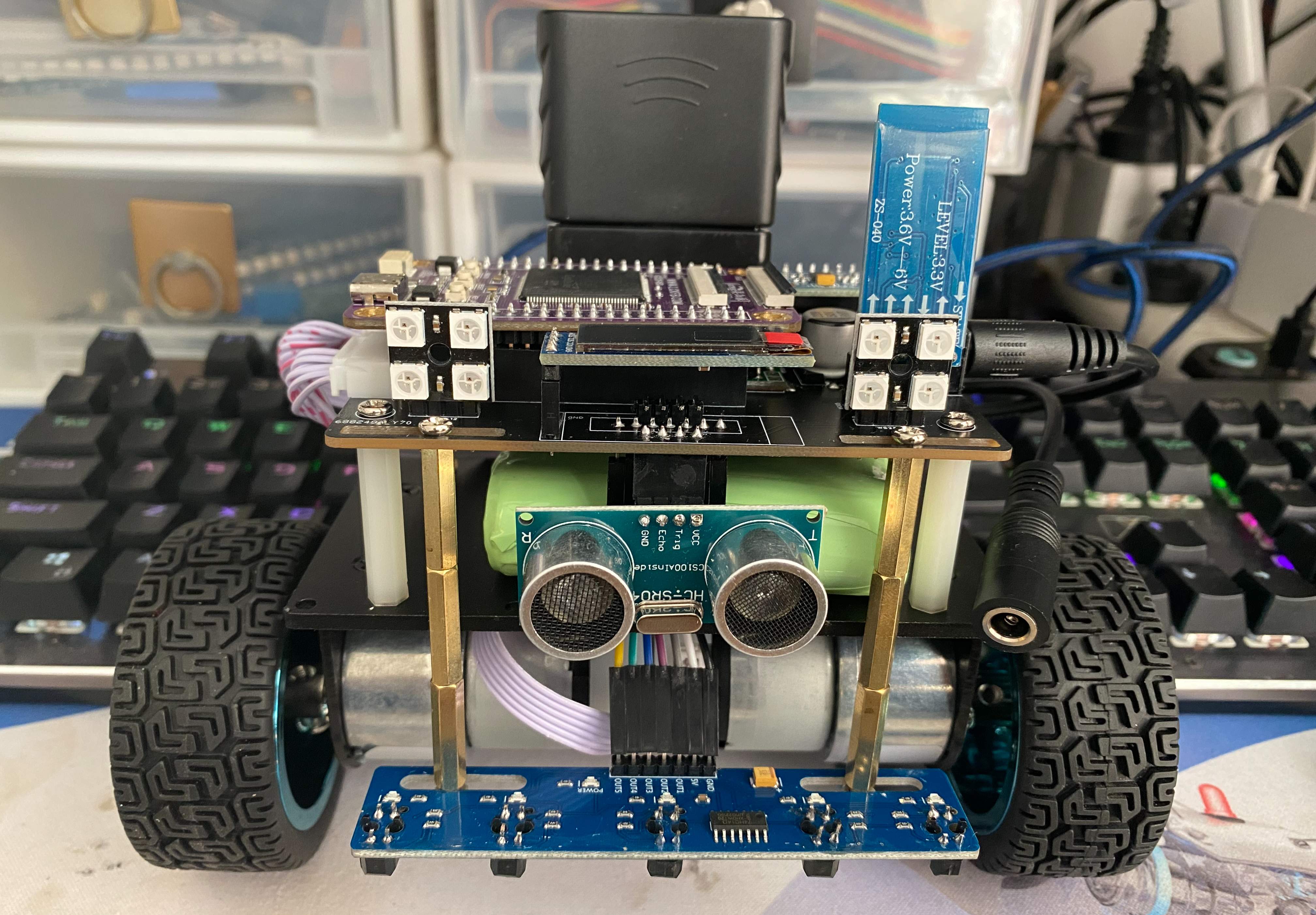

This work is an intelligent balancing car based on the Liangshan School development board made by LiChuang. The car integrates common sensors, controllers and displays. And a serial port is reserved for serial voice or serial peripherals such as OPENMV.
## Functions of the work1
. The car has very complete functions, covering most of the functions we need, such as ultrasonic following, tracking route, Bluetooth control, PS2 game controller remote control, balancing car learning, color light control, etc.
2. The front and rear assembly holes of the car PCB board are reserved for installation of peripherals, such as tracking sensors, distance sensors, visual sensors, etc., which are very convenient to use. **M3 copper columns and screws are preferred for fixing holes.
3. The car motor selects **12V motor with encoder**, so this work uses **12V lithium battery power supply**. Some motor drivers are 7.4V and 9V, please pay attention to the motor selection.
4. The buzzer uses an active buzzer, no PMW is required (the Liangshan School has fewer data lines), but this circuit is also suitable for buzzers controlled by passive PWM mode, which is universal here. (Actually, to reduce code development - lazy)
5. The TB6612FNG motor driver chip uses 12V power supply, and the power supply is directly powered by the battery. Please be careful when welding, please do not short-circuit, and ensure safety before powering on. Or the user can add protection measures by himself, such as adding a voltage regulator chip or a voltage regulator diode. It is recommended to add a voltage regulator diode to 5V, **to ensure that the power supply is correct and will not burn the subsequent circuit! **

## Physical display description
! [Full body photo of the car] ! [Side photo of the car]
## Precautions
When welding, please pay attention to the welding order to ensure that the power supply is not short-circuited and the 5V voltage is not over-voltage. The welding order should follow the principle of from short to small, from inside to outside.
