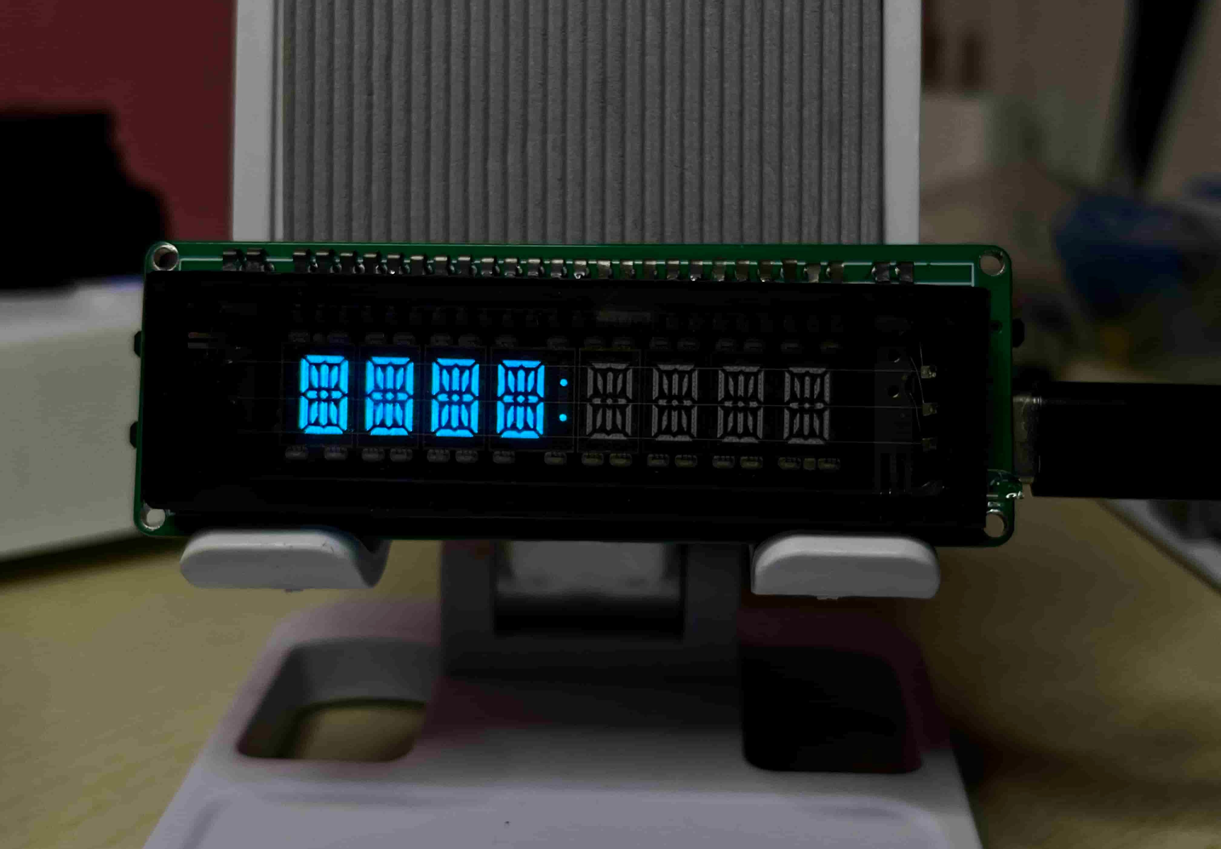

The size is actually not big, it is still relatively small. The color after lighting is blue, the brightness is considerable, the contrast is higher than LED, and the visibility is clear at any angle. This is also the advantage of VFD. The only thing is that it is relatively power-consuming.

### Actual picture
> Mobile phone shooting - The brightness effect is OK, but not very satisfactory.
> This VFD is not cost-effective and is not recommended for purchase. The price of 10 yuan is not worth it.
| ![IMG_2137-cp.jpg] | --- | --- |
| ![IMG_2140-cp.jpg]
