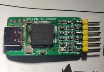

Length 3.5CM * Width 1.8CM
The measured SWD download can reach 12M
The measured JTAG can reach 15M
UART debugging use
Use J-Flash SPI to burn SPI and read 4M Flash in 6 seconds
Known bug: schematic diagram error PB8 is connected to PB9, please modify and verify by yourself
