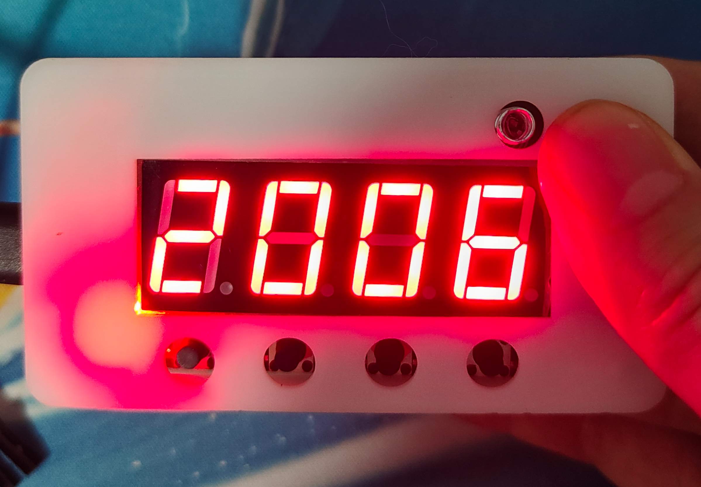

Make a desktop clock that can display time, temperature, and humidity. The time can be set by buttons.
* 2. Project properties
are reproduced according to the 2023 LiChuang Summer Training Camp.
* 3. Open source agreement
GPL3.0 open source agreement;
please fill in the competition stage↓
* 4. The hardware part
is completed using JialiChuang EDA Professional Edition.
* 5.
See the attachment for the software part.
* 6.
See the project details for the BOM list.
* 7. Contest LOGO verifies
personal LOGO.
* 8. Demonstrate your project and record it as a video and upload
it. See the attachment.
* 9. Precautions
When making 3D shells, do not install the size design of the shell when drilling screw holes. It should be about 1.6mm smaller than the size of the upper and lower shells, otherwise the PCB board will be stuck between the gaps between the upper and lower shells, and it cannot be adjusted at all. You can only manually cut the screw holes a little lower.
Be sure to check the screw hole size when making 3D shells. When I was drawing, I remembered that I chose M3 for both the upper and lower shells, but I don’t know which environment had a problem. The diameters of the screw holes of the upper and lower shells were 3.0 and 2.8 respectively, which made it very difficult to install.
The 3D shell design of Jiali Chuang is indeed very convenient.
It is best to prepare a touch spring for capacitive touch.
