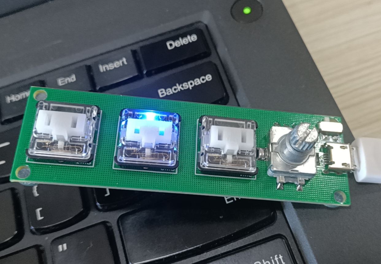

Added three lights for status indication (ping pong key)
Replaced ec11 with patch type
A patchwork program using arduino, development board link https://github.com/DeqingSun/ch55xduino
The hex file in the compressed package is configured to trigger F1/F3/F5 when the light is on, and trigger F2/F4/F6 when the light is off. The encoder presses F7 to rotate left and F8 to the right to F9, but the trigger is not sensitive and is being solved.
See the code at https://github.com/hexesdesu/CH552X_HidKeyboard
