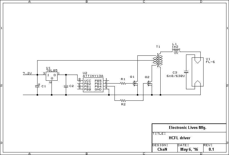

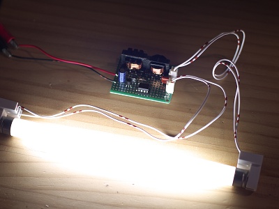

However, the author found a battery-powered fluorescent lamp project on the Internet, which was the same as the schematic diagram the author made at the time. Therefore, the author "revived" the project after 30 years with modern driver circuits and correct theory.
Blockdiagram
