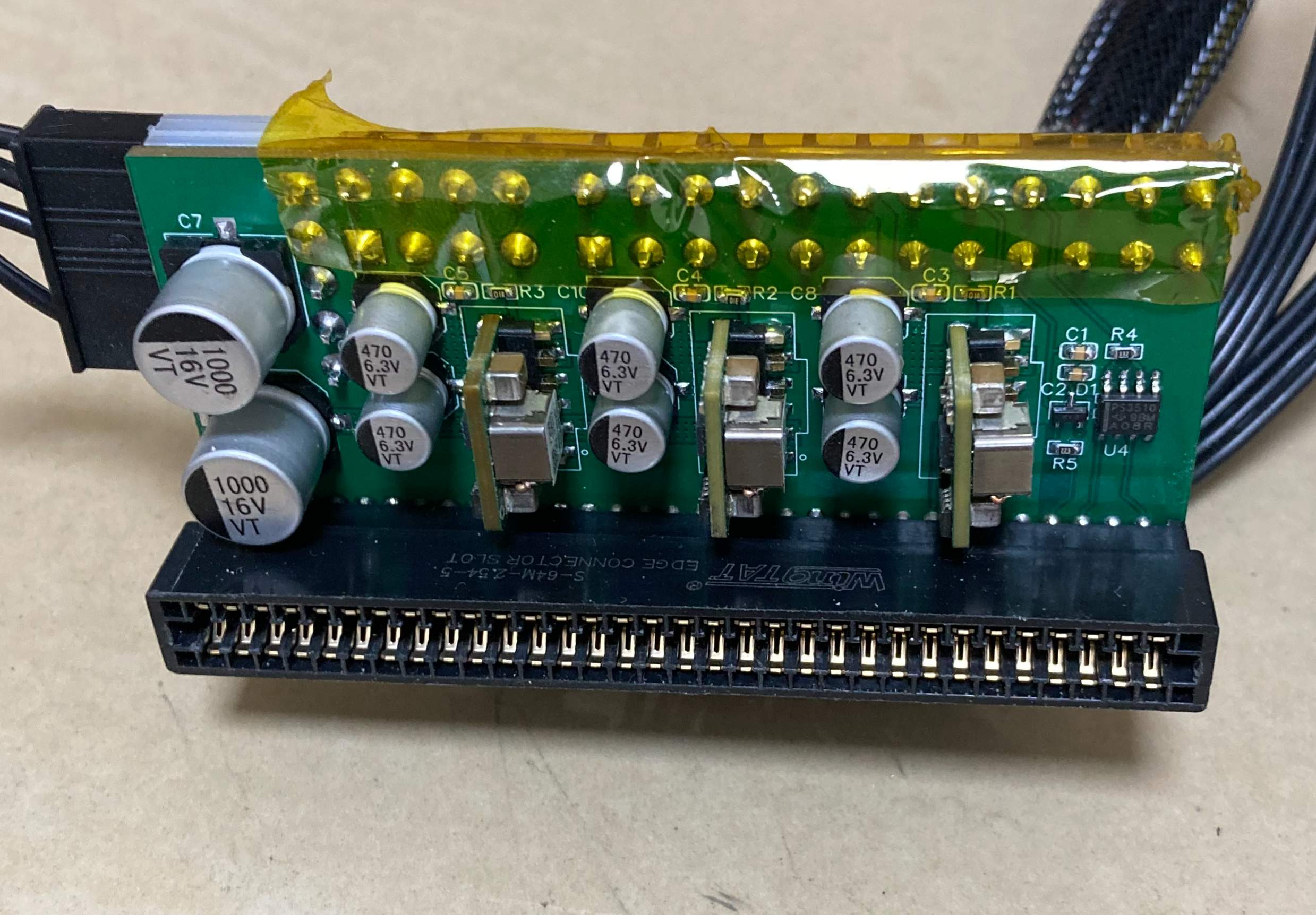

CSPS to ATX module dedicated for Snail C chassis
 The dedicated CSPS to ATX module for the Snail C chassis
adopts a 4-layer board design with a maximum output power of 400W. The interface adopts the Great Wall Dragon line sequence, a 24P motherboard power supply interface, an 8P CPU power supply interface, and a 5P hard disk power supply interface.
When installing, pay attention to the wiring direction and chassis insulation! ! !
Recommended maximum operating current:
3.3V 10A
5V 10A
5VSB 10A
12V 20A
BOM
ID
Name
Designator
Footprint
Quantity
3P straight plug
H1
HDR-TH_3P-P2.54-VM-1
5557 bent pin socket
U6
CONN-TH_8P-P4.20 -S5.50_L12.8-W18.0
U7
CONN-TH_FWF42007-S05B22TK
U5
CONN-TH_C4255WR-2X12P
680uF
C13,C12,C11,C10,C9,C8
CAP- SMD_BD6.3-L6.6-W6.6-FD
1000uF
C7,C6
CAP-SMD_BD10.0-L10.3-W10.3-LS11.0-R-RD
100nF
C5,C4,C3,C1 ,C2
C0603
390Ω
R2
R0603
100Ω
R3,R1
R0603
BAT54C
D1
SOT-23-3_L2.9-W1.6-P1.90-LS2.8-BR
3.3KΩ
R4
R0603
TPS3510DR
U4
SOP8
22KΩ
R5
R0603
ZXDN10S1205SAW
U3,U2,U1
ZXDN10S1205SAW-NEW
Noguchi 64-pin
WINGTAT S-64L-2.54-5-CSPS
