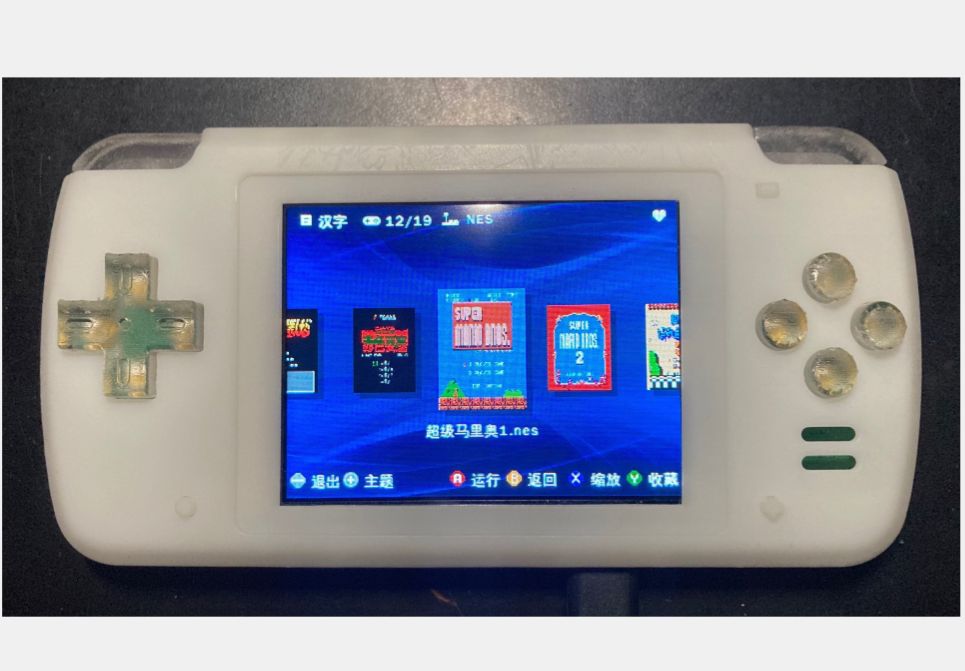

It is modified based on the horizontal version handheld console of mlpzaq9998 (Link: Allwinner V3S Game Console-Low Cost), with the following main changes:
0. The overall size is larger than the original horizontal version, about 12x5.2cm, with an increase of Arc around.
1. Replace the 2.4-inch TN screen with a 2.8-inch IPS screen with a resolution of 320X240.
2. Replace the silent buttons with dome-shaped buttons for a better feel.
3. Replace the direction joystick with the cross key to play games more smoothly.
4. Rearrange the keys to provide more operating space.
5. Add hardware switches that were ignored in the original horizontal version, so as to say goodbye to the trouble of automatic power-on during charging.
6. The screen is replaced with a plug-in version, which is easier to replace.
7. Add sockets for batteries and speakers.
8. Thanks to the group friends "Good Night" for carefully drawing the matching shell, which is currently being verified and will be released soon!
9. It has been verified and the firmware has been adapted. If you need firmware, please join the group.
10. The Chinese version of FunKeys system has been released, providing a better experience!
