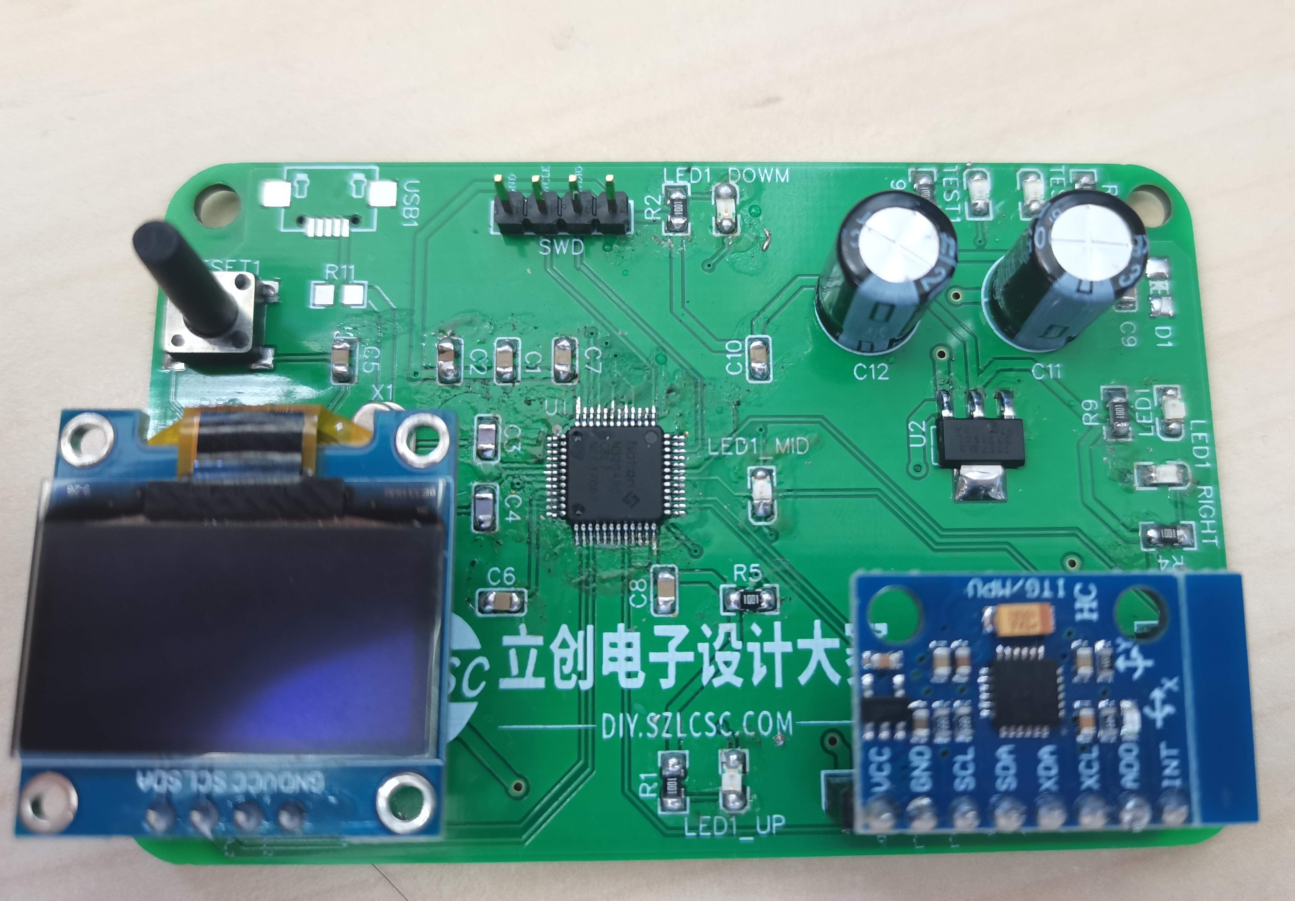

       Collect attitude data and convert it into the real-time attitude of the module and display it on the OLED. At the same time, use pwm to control the brightness of the light, which represents the degree of inclination. The greater the inclination, the brighter the light on the corresponding side. This design can be used for attitude control of robots and quadcopters after improvement.

is mainly based on the tutorial, and the minimum system of the microcontroller, 5v to 3v module, MPU6050 interface, and OLED interface are designed.
The principles involved are I2C knowledge and module usage knowledge.

uses the kile5 compiler. According to the tutorial, the program is rewritten. The main function is to add the timer output function, and the LED is controlled by writing a program.
