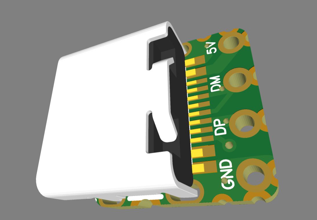

TYPE-C adapter board
For device interface modification, the USB interface of micro and mini can be easily replaced with a type-c interface, which facilitates the soldering of flying wires on the board. It is compact and easy to embed. The PCB can be produced with a thickness of 1.0mm. There is a reinforced structure grounding pad on the side of the PCB for more reliable welding.
Remember to note when PCB proofing: No half-hole process is required! , otherwise an additional half-hole process fee will be charged during production.
