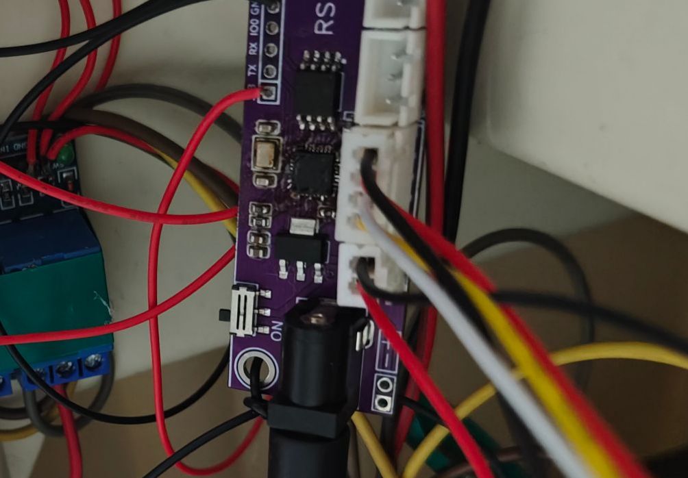

The actual picture of the equipment is as follows:
Equipment description:
This equipment is an electronic timer made by ESP8266EX as the main controller to replace the washing timer function of the washing machine. Its pin definitions are as follows:
1. Reserved holes for microcontroller program burning: Upper There is a 1x5p 2.54mm binding post in the upper right corner of the picture, which is used to program the device. Its pin definitions have been marked. Please learn how to program the ESP8266EX by yourself.
2. MCU reset button RST: When the button is not pressed, the MCU RST pin is high level. When pressed, the pin is pulled down, so the MCU restarts. It is used to restart the MCU during debugging.
3. Equipment power input: There are two power input methods on the left side of the circuit board, which are suitable for DC head or wire welding. You can choose according to your own power adapter. The power input should be between 12V-6V. It is recommended to use a 12V power adapter. .
4. Power switch in the upper left corner: This switch controls the power switch of the device and has been marked with silk screen on the side.

6. Relay interface: There are two relay interfaces on the right side of the device:
The definitions are as follows:
The relay interface corresponds to the relay module. Let’s talk about relay selection:
When choosing a relay module, please select the following specifications: 5V voltage input, low level trigger Suction.
