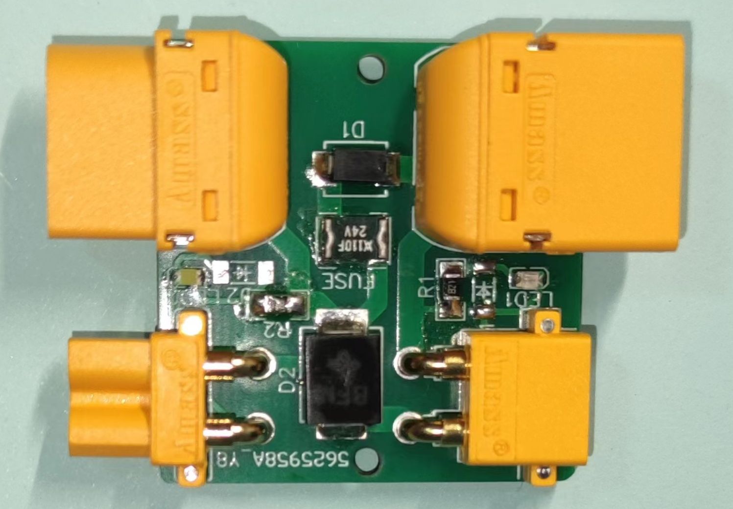

XT60&XT30 model aircraft battery protection board
XT30
& So I designed a protective board myself, and Jialichuang made the board for free.
PS: Zener diodes, TVS diodes, and Schottky diodes are additional protection devices and do not need to be soldered. A self-restoring fuse must be installed to prevent overcurrent.
If the LED lights on both sides are on, it means it is normal. If only one side of the light is on, it means that the self-restoring fuse operates to cut off the current.
