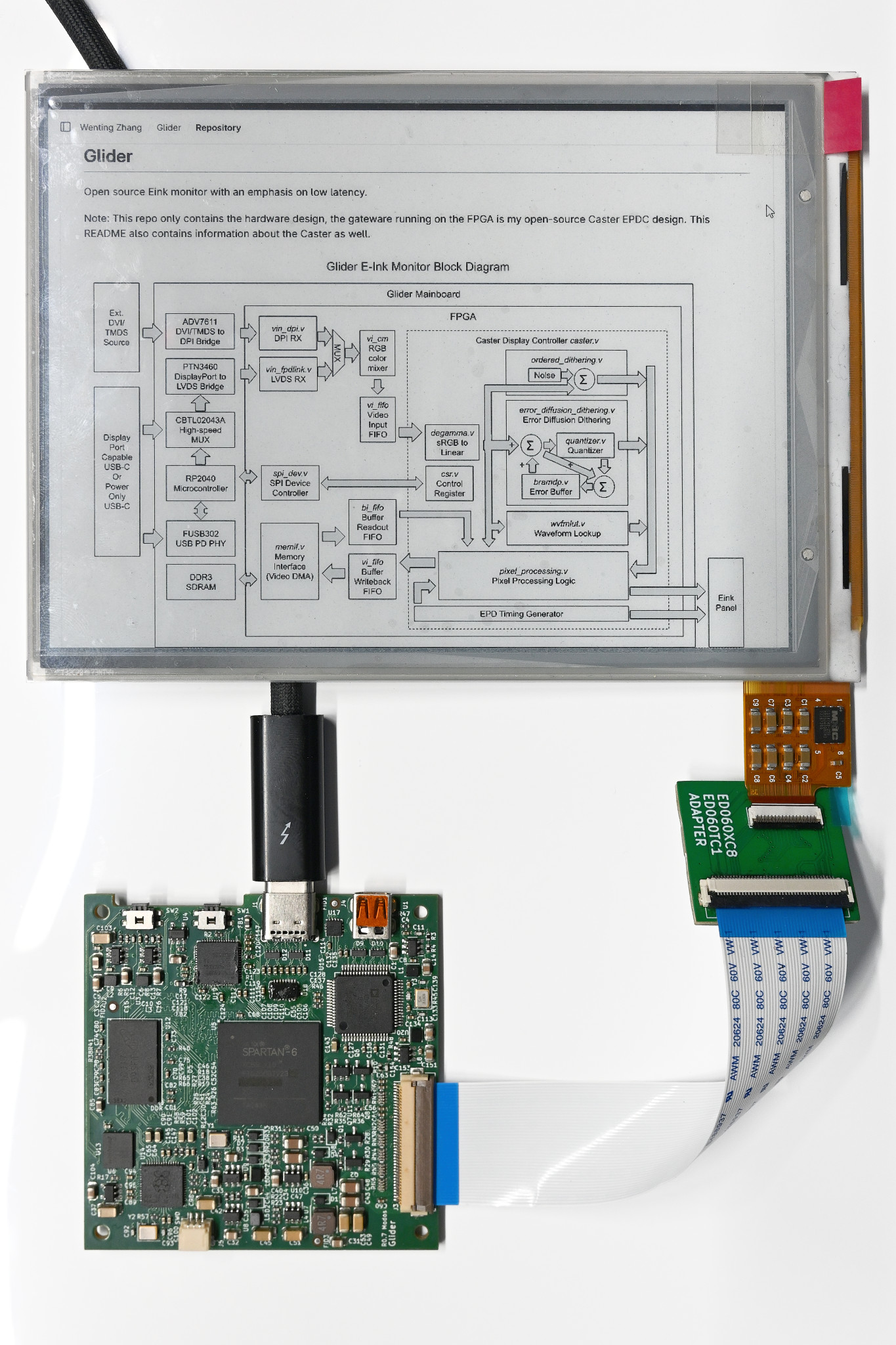

The author not only shares information about the project, but also shares almost everything the author knows about Eink in detail, given that it is a bit difficult to gather information about Eink online. Project Features:Complete solution for low latency/high refresh rate EPD monitorsSupports electrophoretic display panels with parallel I/F (Eink(R), SiPix and DES)Supports color screens based on monochrome and color filter arrays (such as Kaleido(TM))Extremely low processing latency <20 usSupports binary, 4-level grayscale, 16-level grayscale output modesLatency-optimized binary and 4-level grayscale drive modesMixed automatic binary and 16-level grayscale drive modesControllable region update and mode switching during host software runtimeHardware Bayer dithering, blue noise dithering and error diffusion dithering without additional latencyController natively supports FPD-Link (LVDS), DVI (TMDS) and MIPI-DSI inputBoard-level design supports USB-C (USB Type-C DisplayPort Alt Mode) and DVI inputHardware Description:Xilinx(R) Spartan-6 LX16 FPGA running CasterDDR3-800 frame buffer memoryType-C DisplayPort Alt-Mode video input with onboard PTN3460 DP-LVDS Bridge or DVI (via microHDMI connector) video input with onboard ADV7611 decoderEpaper power supply with up to 1A peak current on +/-15V rail, supports large panelsVCOM kickback voltage measurement supportOnboard RaspberryPi(R) RP2040 microcontroller for USB communication and firmware upgradesProcessing rate up to 133MP/s with jitter enabled, >200MP/s with jitter disabledThe board was designed using KiCad. You may need the latest stable version of KiCad to open the source files.
