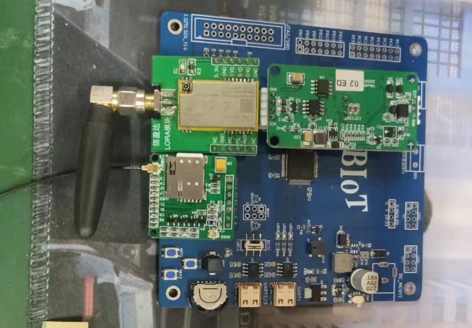

NBIoT gateway based on STM32
Quectel BC20 is used as the gateway to transmit data to Alibaba Cloud.
LORA communication is used between the gateway and each node. The node is responsible for collecting sensor data and sending it to the gateway.
A 0.96-inch OLED display is used to display the sensor data sent by the node.
参考设计图片
