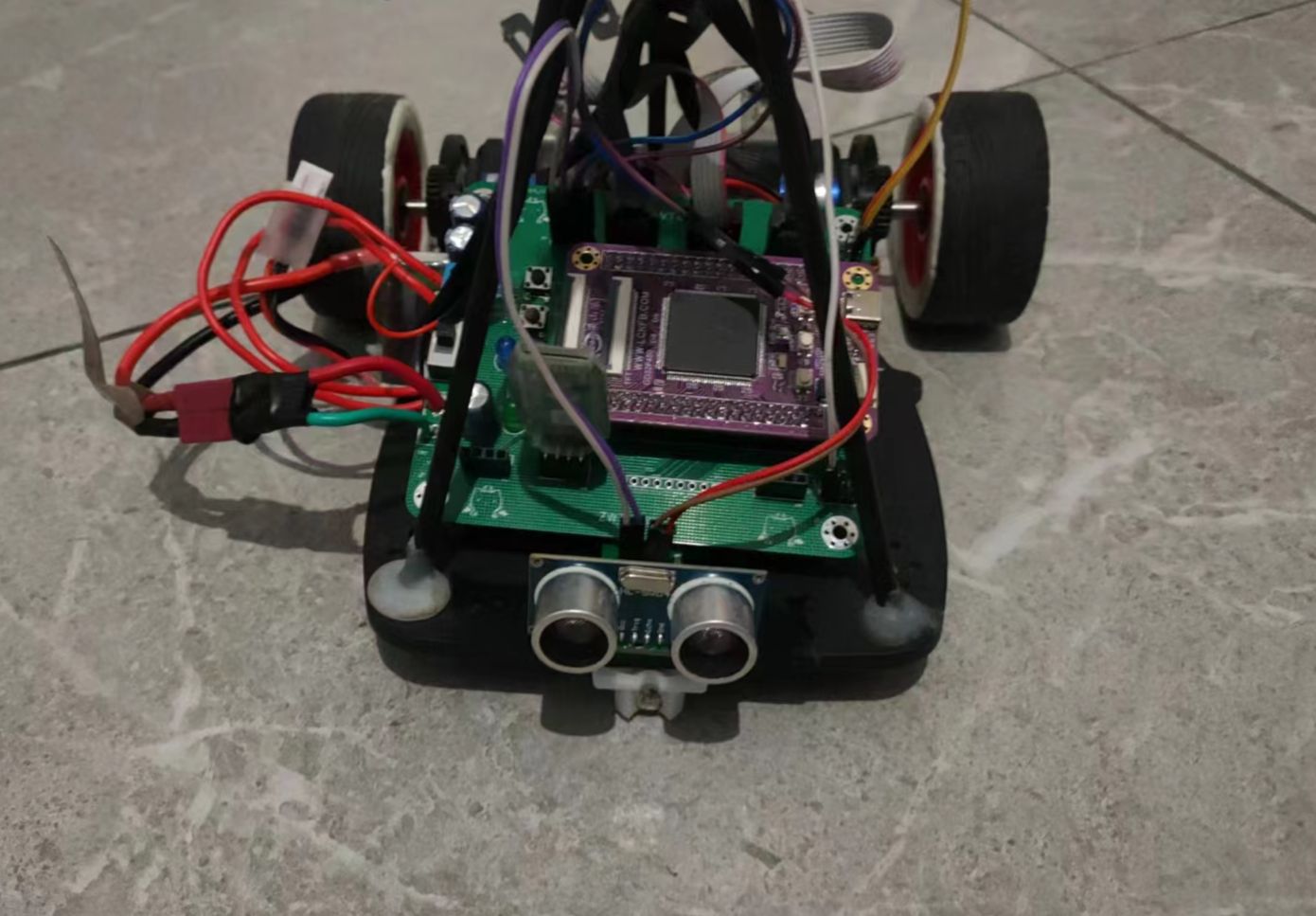

Based on the smart car motherboard produced by Liangshan School, its functions include obstacle avoidance, ranging, tracking, and Bluetooth communication. It has an ISP screen for easy debugging, an encoder interface, and can control the car PID, as well as lights and power indicators.
Preview image
Actual
image of the car Overall view of the car
The motor drive of the car uses a dual-channel drive board controlled by the IR2104 chip. The left and right steering of the car relies on the differential speed of the motor. Due to the impact of the epidemic, many functions have not been perfected. Currently, only the obstacle avoidance function is implemented. , the functions will be gradually improved in the future.
The motherboard power supply circuit part
of the car uses a 7.8V model aircraft battery as the power supply. Jiangsu Changjing's CJ7805 linear voltage regulator is selected to convert the 7.8V voltage into the 5V power supply required by the Liangshan School and some peripherals. In addition, an electrolytic capacitor to improve the load capacity of the chip. Use the common AMS1117 to achieve step-by-step voltage reduction to power other peripherals.
