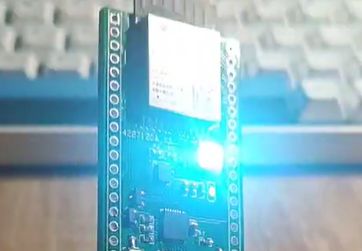

Development board based on ESP32-S3-WROOM-1-N8R2.
I have a few ESP32S3 modules on hand, ready to be made into development boards, so I’ll send them out by the way.
9.9 The verification is done and the verification is successful.
  Well, the verification was successful. The serial port chip used this time is CP2102GMR, and the power supply is the high-efficiency low-ripple BUCK solution of MPM3810. After all, the power consumption of ESP32-S3 is not small.
       (The stress test was completed on September 10th. The full-brightness RGB light and Bluetooth were turned on for a long time. The ESP32-S3 module was warm. The MP3810 was at the same temperature as the board and no heat was felt.)
  There are two indicator lights on the entire development board, one is the MPM3810 The POWER GOOD indicator light also uses a WS2812 RGB lamp bead as the onboard program indicator light, and the DATA connection is IO48.
