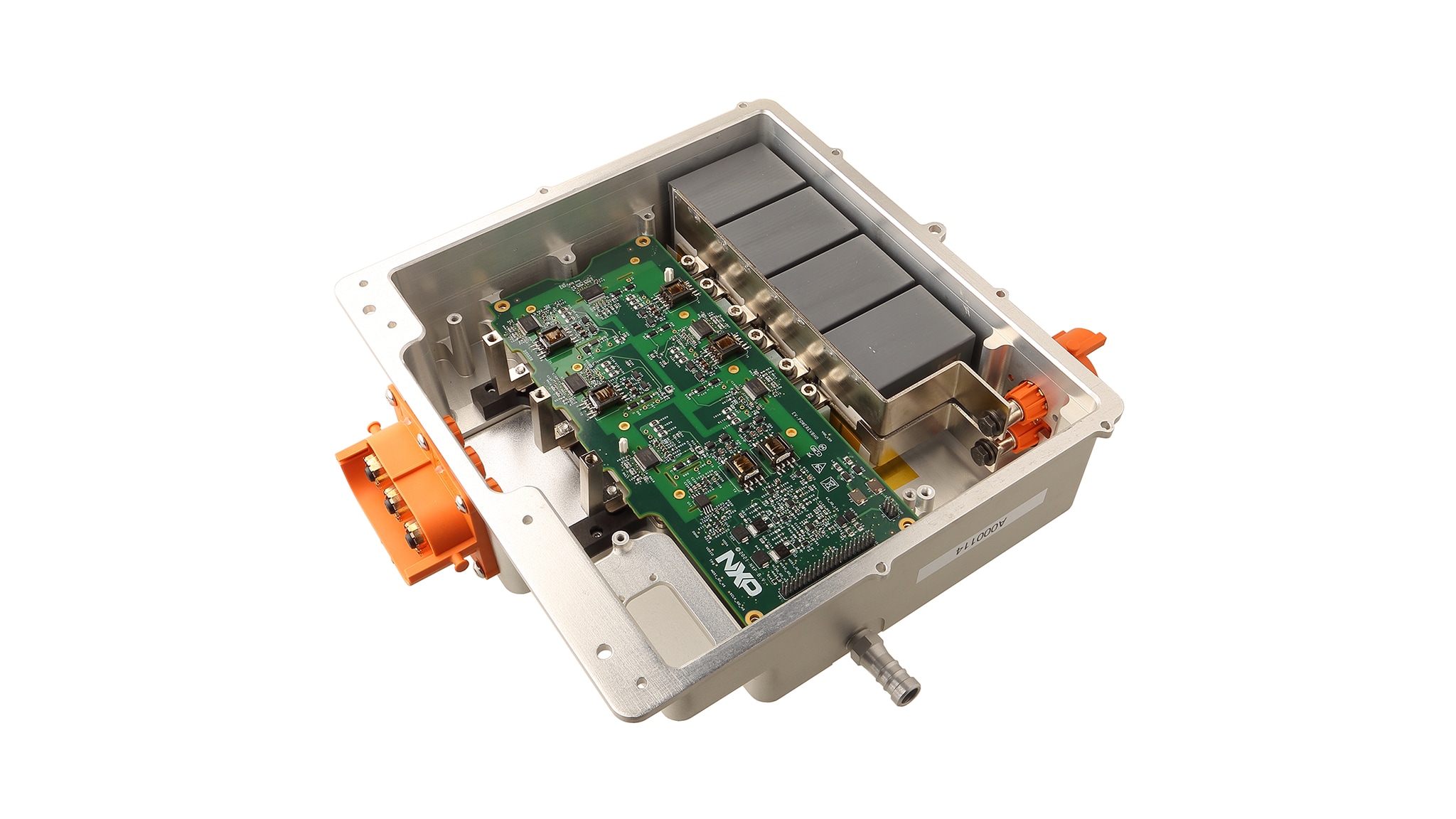

This second-generation automotive-grade IGBT/SiC-EV power inverter control reference platform includes the following changes:
Standard form factor P6 HybridDrive power module compliant with onsemi VE-Trac™ and Infineon HybridPACK™ IGBT modules such as those using Cree SiC chips Evaluation criteria for StarPower P6 module)
Migrate from GD3100 gate driver to GD3160, improving efficiency and IGBT/SiC compatibility
Adding Ethernet interface capabilities with THA1100
Achieving higher output voltage and higher power density
System IP using inline Software interpreter in the MCU, eliminating the need for a hardware interpreter, thereby reducing the BOM count of the system.
To ensure a high level of functional safety to protect vehicle operators as well as first-generation systems, the enablement kit includes a system-level functional safety white paper, Device FMEDA and functional safety runtime framework for ASIL C/D EV-inverter implementation customers.
Functional safety consulting and safety software are optional additional services offered by the platform.
This platform lays a comprehensive foundation for the development of IGBT inverter control system solutions and has been verified and dynamically tested.
Vepco Technologies Inc. provides a complete inverter control reference platform including 4 boards, IGBT modules, DC Link capacitors, busbars, cooling plates, motor options, chassis and software.
