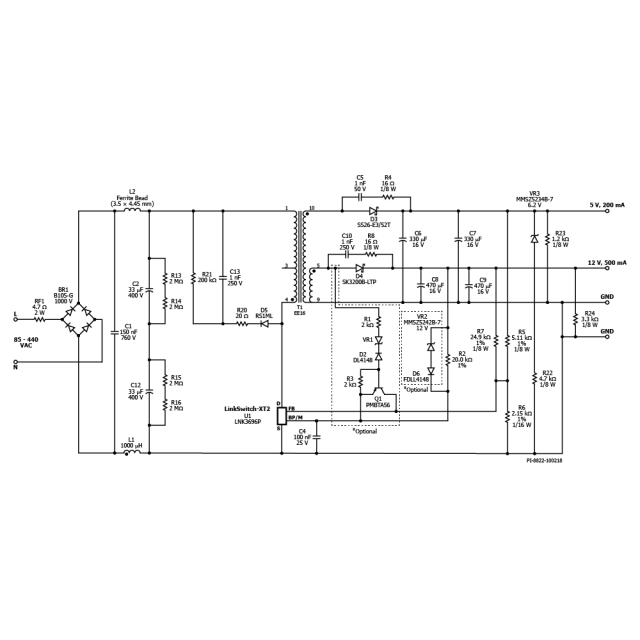

RDR-736 - 7 W wide-range input, dual output, non-isolated flyback converter using LinkSwitch-XT2 900 V
RDR-736 - 7 W Wide-Range Input, Dual Output, Non-Isolated Flyback Converter Using LinkSwitch-XT2 900 V
This engineering report describes a non-isolated flyback converter designed to provide dual outputs of 5 V (200 mA) and 12 V (500 mA) over a wide input voltage range of 85 VAC to 440 VAC. This adapter uses the LNK3696P from the LinkSwitch-XT2 900 V series of devices. This document contains power supply specifications, schematics, bill of materials, transformer documentation, printed circuit layout and performance data
