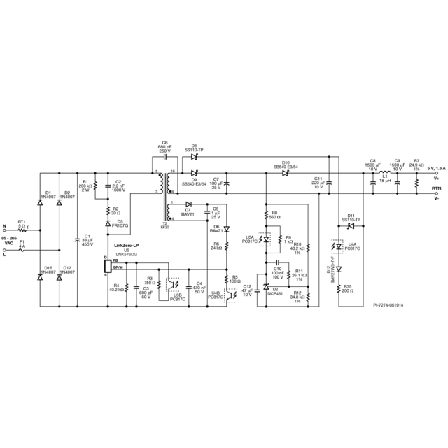

DER-417 - <5 mW no-load input power, 8 W backup power
DER-417 - <5 mW No-Load Input Power, 8 W Standby Power Supply
The report describes a universal input 5 V, 1.6 A flyback power supply using the LinkZero-LP family of ICs. It contains complete specifications of the power supply, detailed circuit diagrams, a complete list of materials required to build the power supply, extensive documentation of the power transformer, and test data and oscilloscopes of important electrical waveforms
