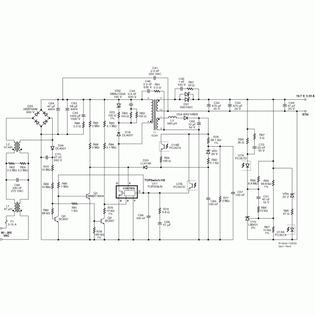

The engineering report describes a laptop adapter power supply demonstration board using the TOPSwitch-HX TOP259LN. The power supply operates from a universal input and provides 19.7 V, 65 W continuous output. TOPSwitch-HX maintains constant efficiency over a very wide load range, eliminating the need for special operating modes for specific load thresholds. This optimizes performance with existing and emerging energy efficiency regulations such as 1 W standby, 1.7 W and 2.4 W sleep modes, as well as Energy Star 2.0 >87% average efficiency requirements. TOPSwitch products provide constant efficiency that meets average efficiency requirements, ensuring design optimization for future changes in energy efficiency regulations without the need for redesign. This document provides complete design information, including specifications, schematics, and bill of materials for this power supply design. Performance results are also provided, including regulation, efficiency, standby, transient load, power limit data, and conducted EMI test results.
