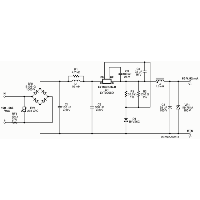

RDR-378 - 7 W non-dimmable, non-isolated, step-down LED driver for A19 and A17 lamps
The document introduces a highly compact and cost-effective step-down power supply designed using the LYTSwitch-0 series device (LYT0006D). The power supply can operate from an input voltage range of 190 VAC to 265 VAC. When using a buck topology, the DC bus voltage is sufficient to support an 85 V output - in a buck converter, the output voltage must always be lower than the input voltage. In addition, the output voltage is also limited by the maximum duty cycle of LYTSwitch-0 (which also requires that the input voltage must be higher than the output voltage). This reference design is not limited to replacement lamp applications; the design layout can be easily modified to fit into an LED tube or ballast power supply.
