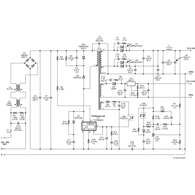

DER-218 - 100 W cooling power supply
DER-218 - 100 W Refrigeration Power Supply
This document is an engineering report describing a refrigerator application power supply utilizing the TOP260EN (TOPSwitch®-HX Series). The power supply has two outputs: 12 V, 8 A and 8 V, 0.4 A. This document contains power supply specifications, schematics, bill of materials, transformer documentation and performance data
