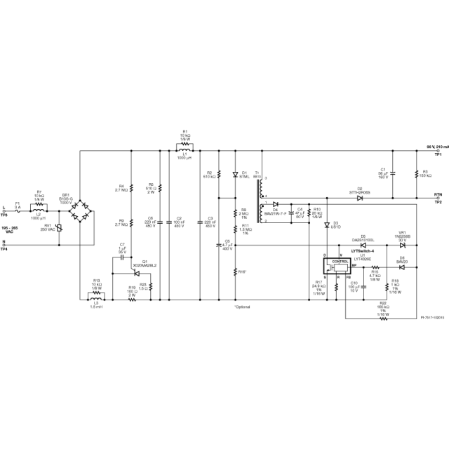

DER-445 - 20 W Power Factor Corrected, Non-Isolated, TRIAC Dimmable LED Driver
This document describes a non-isolated, high power factor (PF), TRIAC dimmable LED driver designed to drive 96 V at 210 mA from a high line input voltage range of 195 VAC to 265 VAC (50 Hz typical). Nominal LED string voltage. The LED driver uses LYT4326E in the LYTSwitch-4 series IC. The topology used is a single-stage non-isolated buck-boost, which meets the constant current regulation and dimming requirements of this design. This document contains LED driver specifications, schematics, PCB details, bill of materials, transformer documentation and typical performance characteristics
