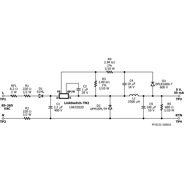

DER-507 - 175 mW Constant Voltage, Universal Input, Non-Isolated Buck Converter
This engineering report describes a buck converter power supply designed to provide a nominal output voltage of 5 V over a wide input voltage range from 85 VAC to 265 VAC at a 35 mA load. It utilizes the LNK3202D from the LinkSwitchTM-TN2 series of devices. LinkSwitch-TN2 ICs are specifically designed to replace all linear and capacitively fed (capacitive dropper) non-isolated power supplies in the output current range below 360 mA at the same system cost while providing higher performance and energy efficiency. The DER-507 provides a single 5 V step-down output. A key design goal is to provide a low-cost solution for adapter applications. This file contains power supply specifications, schematics, bill of materials, transformer documentation, printed circuit layout, performance and test data
