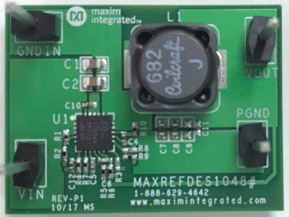

A small size, high-efficiency buck converter using the MAX17504 is demonstrated for a 3.3V/3A application.
Designed, Built, Tested
This document describes the hardware shown in Figure 1. It provides a detailed systematic technical guide to design in a high-efficiency buck converter using the MAX17504 step-down DC-DC converter. The power supply has been built and tested, details of which follow later in this document.
