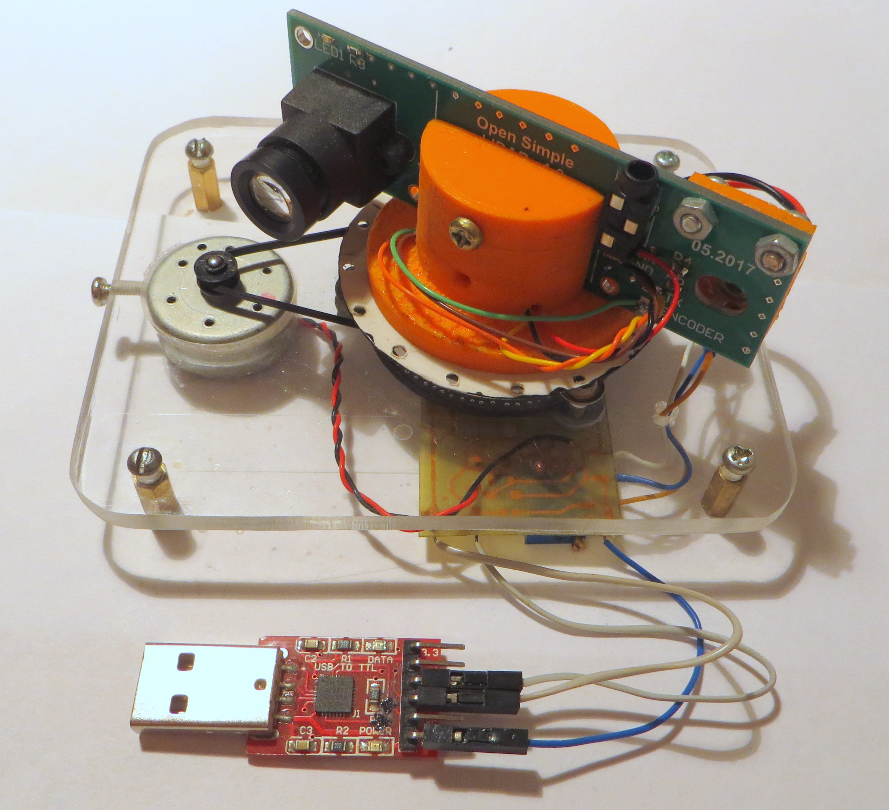

OpenSimpleLidar: Open source laser rangefinder for SLAM and navigation
This is a very simple open source scanning laser rangefinder. It uses triangulation. Its components cost less than $35 (excluding shipping). This lidar is very useful in robotics - for SLAM and navigation tasks. Parameters: - 5 scans per second - 180 measurements per revolution (2 degree angular resolution) - Maximum distance 4 meters - Measurement accuracy is about 3-5 cm at 3 meters (depending on the color of the reflective surface)
